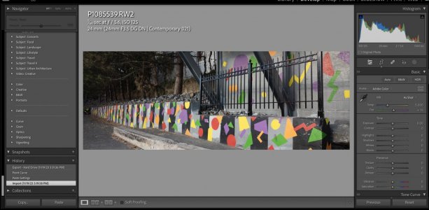

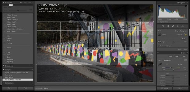

What happens in the viewfinder when you change the aspect ratio? Does it show a frame in the full frame or blank out outside the changed aspect ratio? What about the raw files? Do they capture the full frame but get cropped and the rest is accessible or are those data dumped?
It has 5 sensitivity settings (-2 through +2) and can be set to your choice of one of 10 different colors. You can set it so it is off on AFS and turns on when you flip the switch to MF and you can also assign it to a control. I have mine set for the lower front switch to turn it on or off. I just don't use it that often due to how high the EVFs resolution is.
When you shoot in alternative ratios it shows just the AR selected. It also gives you an option of making the border of the frame slightly illuminated which is handy if you are shooting 65:24 with a dark image so that you can see the framing borders against the blacked out sections of the viewfinder/LCD. You can see what it looks like here. I have the AR selections mapped to the V-Mode button on the side of the EVF so I just press the button and either use the D pad or either command dial to change AR.
The RAW file capture the full sensor data but with the crop applied in the EXIF. When you import them into LR it shows the image with the crop but if you press the crop button you see the full sensor data. JPEGs are obviously just the cropped image.
This is what a 65:24 RAW looks like on import.

And this is when you press the crop button.
