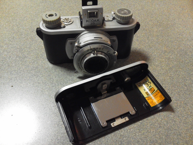

Here's the Kodak 35. I wouldn't think a shiny steel plate would be a good idea, although I haven't heard in Internet forums that it caused the film to fog.
Still, it doesn't seem like a good idea.
