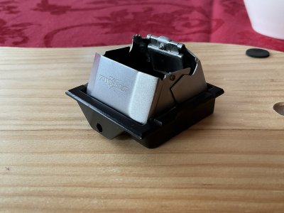

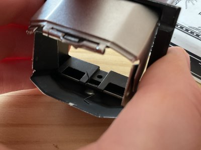

Hello,
I recently picked up an Edixa Reflex A to learn to tune up. One aspect I am excited to try is the waist level viewfinder, however it appears it is missing the mechanism that holds it closed and opens the doors. I am wondering if anyone is able to take well lit photos of their unit (or measurements) showing this missing piece, or provide feedback on how theirs closes and opens up.
Is appears a pin/dowel and metal bar are missing on the side that faces towards the user. I have attached photos of my unit as well as one off the web showing what is missing.
[reference photo 1] https://www.khasakh.com/?e=20716493011630
[reference photo 2] Wirgin Edixa Waist Level Viewfinder
[remaining photos mine]
Thanks! New member so let me know if there is more I can provide.

I just grabbed mine off the shelf - first thing you should know is that it's threaded and holds a bent piece of metal in place:
The head sits unusually proud of the surface:
And is predictably a flat slot head:
I'm not going to do exploratory disassembly on mine at the mo, but my verniers make the total length (from top of head to end of threaded shaft) 13.5mm and the head itself measures 3.5mm and sits 2.25mm proud of the rear edge of the viewfinder before it's depressed.
Hopefully you can repair it - while the prism finder is much easier to use, the WLF just feels right on an Edixa. These things are lovely.
Does the screw have a spring being it as well? Seems like there's space for one.
