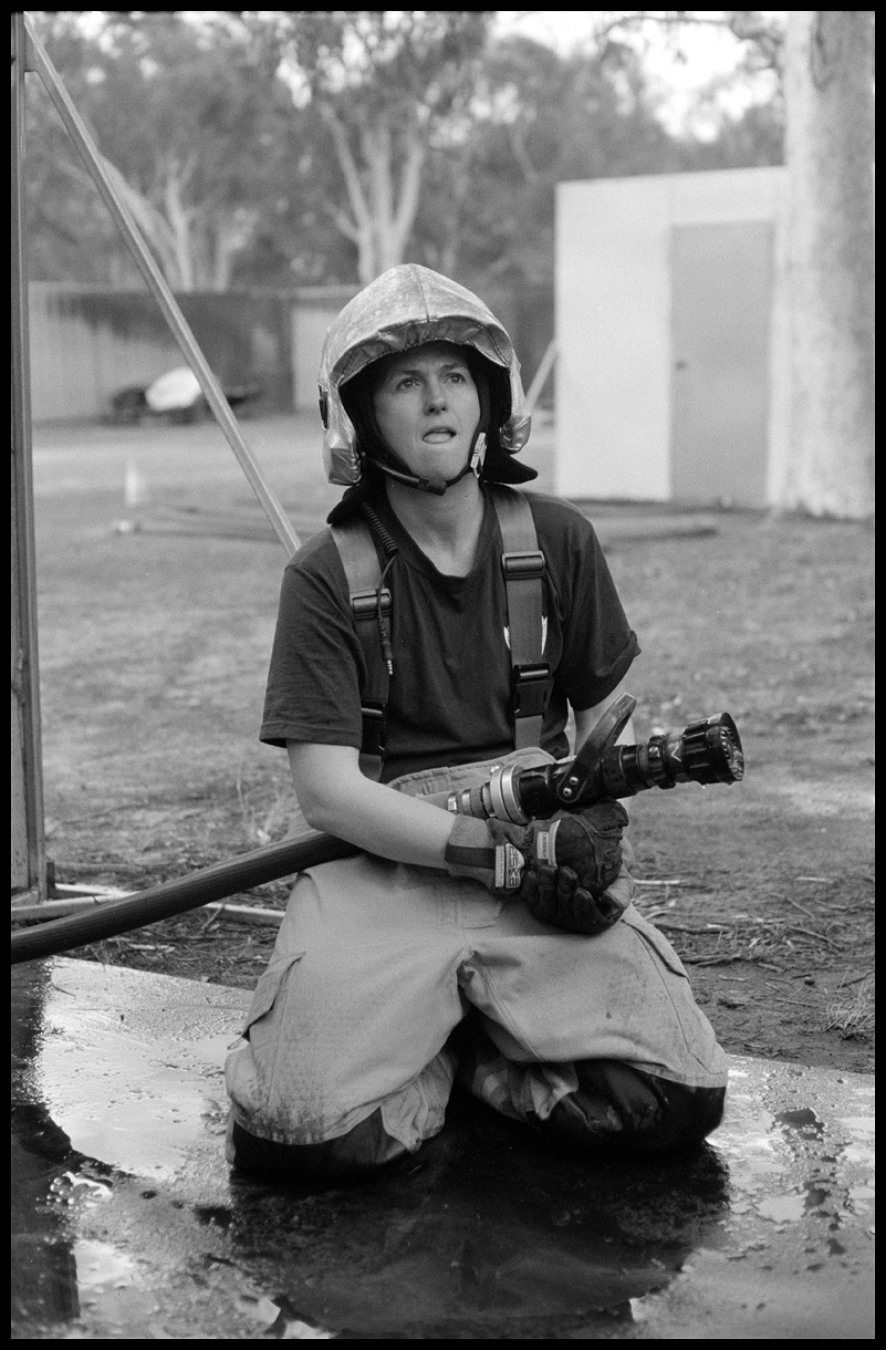

A selection of informal portraits taken this week on Foma 200 and Ilford Delta 400. Both films developed in Fomadon LQN. Foma 200 is fast becoming my film for all occasions, with the Delta 400 for pushing to 1600 when necessary.
Winter in Australia produces a clear, lower angle somewhat harsh light. Both films handled the contrast well as can be seen in the shadow area on the face caused by the front of the helmet.
Camera: Leica R8 with 50/2 Summicron (Canadian).
Scanner: Plustek 8100 (scanned as slide film, inverted and resized from 3600 dpi).
Delta 400
Delta 400
Foma 200
Foma 200
Foma 200
Cheers - John
Excellent portraits John! I prefer the Foma 200 results.

Nice work John!
I've never had much luck with Foma 200 but I think I developed in ID-11. The shadows were very empty.
I've settled on Foma 400 rated at 250* in LQN for 7 min (as per Foma's data sheet). Thanks for putting me onto Blanco Negro too, it's nice to be able to buy from a local supplier who actually cares. Top notch service every time.
*I find 250 gives better shadow tones than 320 and it makes it easier on my head to sunny 16 it. 1/250 just happens to be on the shutter dial, 1/320 is not 🙂
Thanks Michael. I can't fault Foma 200 but I have only ever used LQN as bought 5 litres off Chris at Blanco Negro. I think it's the only developer that gives it the rated speed. I buy it by the 30m can and is my standard medium speed.
Yes, it's great to be able to buy local and such good prices as well. Each birthday my kids sent him some money for me to spent so I'll be heading there on Wednesday. This time some 200 in 120.
I just wish Foma had a film that pushed well, then I'd be set. Had to hit B&H for a couple of cans of Delta 400 which is working well for me at 800 in DDX. Unfortunately I've run out of DDX so I will try Microphen.
Cheers - John
As you have found, Fomapan 200 will loose speed in D-76/ID-11, it is closer to EI100 with that developer and also contrast builds up very quickly, so it's probably not the best choice for this film, at least when shadow detail is important. The Foma data sheet shows this very clearly. OTOH, in both LQN (1+10) and Xtol (stock) Foma 200 will reach a speed of around 160 (close enough to 200 for practical purposes) with a reasonable gamma (0.6). John's photographs illustrate this very nicely.
