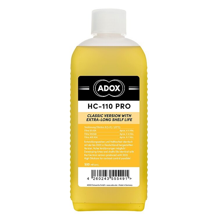

I don't see the original HC-110 available for sale anymore. Is it available somewhere/anywhere?

You can buy the HC110 made by Adox these days. It is the same stuff.

Today I have looked at what has been described with your individual findings and constructed a strategy to as Freakscene says get dialled in to this outdated film. The nice people at FirstCall photographic have delivered a bottle of Adox HC 110 it appears to be well used on outdated film. I have 700ft of the product I don't want to arrive at the 650ft used saying I'm nearly there. Here we go.
With 700' of film available to you, you have more than enough scope to determine exposure and development by experimentation.
You don't need to load full 36exp rolls for testing, 10 exp rolls will do. Delta being a tabular grain film, I'd start with Ilford's current recommendations and go from there, exposure determines how dense your negatives are, development controls how contrasty they are (and grain characteristics). Any mastery of the medium requires experimentation regardless of the age of the film, you are lucky to have so much material to work with
Just make sure it’s this one ADOX HC-110 PRO ''Original Syrup'' Made in Germany 500 ml conc. - fotoimpex.com analogue photography - they also sell other “110” developers that are different.
