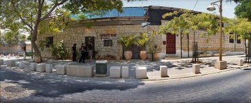

The attached was one of many Reala photos I did yesterday with handheld meter, Horizon pano camera at 1/125 f/11.
The meter reading were: for shadows area1/125 f/8 and for the bright areas 1/250 f/16.
If I shot same location on Astia slide will the image be over or under exposed?

Slide film has a few stops less exposure lattitude than negative film, so in your example, the sunlit areas would be a bit lighter and possibly washed out, and the shadow areas would be darker. Typically with slide film one exposes for the highlights so they don't burn out, and one lets the darker areas go dark. With negative film, the best plan (usually) is to expose generously for the shadows and develop and/or print for the highlights.

If you shoot the same scene with Astia slide film, it's not going to fit into the mount.
I'm not actually familiar with Astia. I've shot lots more Kodachrome, Velvia, Agfachrome, 3M, etc. Generally, I would agree with Frank. I tend to expose for the highlights.
