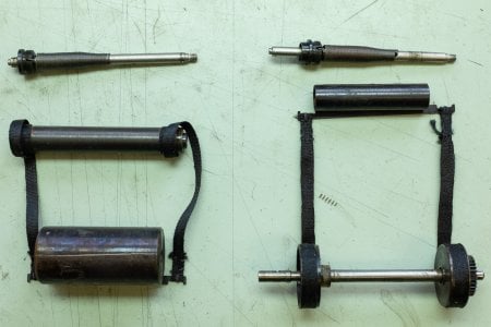

Here's what some of the old grease that I cleaned out of my Zorki 1 looked like:
The roller springs and shafts (up top in photo) were coated in a similar waxy, pasty residue:
Cleaning that sort of stuff out and replacing it with fresh lubes made my Zorki a reliable camera. I think it's the only way to make one work well. Splashing fresh oil on top of that old rancid paste is a temporary solution at best.
