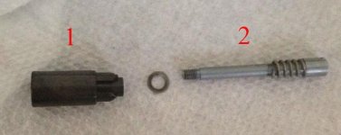

1. check the inside take up spool, there should be two little pegs (see photo 1). If you have an old metal (brass) take up spool, the little pegs may wear out, the pegs may not engage the clutch drum's slots ( see photo 2, the part labeled as "1"). If you move the take up spool the clutch drum should be move too. If the take up spool moves freely but the clutch drum does not move, the pegs is too short.
2. clean and adjust the clutch drum (photo 2). Use a long blade screw drive to unscrew the part 2, if the clutch drum friction is too little, stretch the spring to increase strength and increase the friction of clutch drum.
