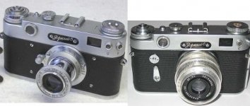

Which Zorki-5's have the square rangefinder window? I had been thinking of using the top cover from one of those to put it on my otherwise fine Zorki-6.
reagan
hey, they're only Zorkis
Looks like there's "Type.1" and "Type.2" ..... check it out.rxmd said:Which Zorki-5's have the square rangefinder window? I had been thinking of using the top cover from one of those to put it on my otherwise fine Zorki-6.
http://www.russianplaza.com/Zorki I 1 2 3 4 5 6 C M.htm
Mine has the round and is has a very distinct and good sized round RF patch. I rather like it.
That's what had crossed my mind also. I think that it would take a little more engineering than I would want as the top casing is higher than the 6. Even the 5b has a higher casing, which otherwise looks identical to the 6.
