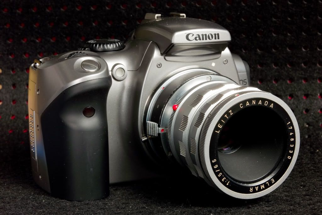

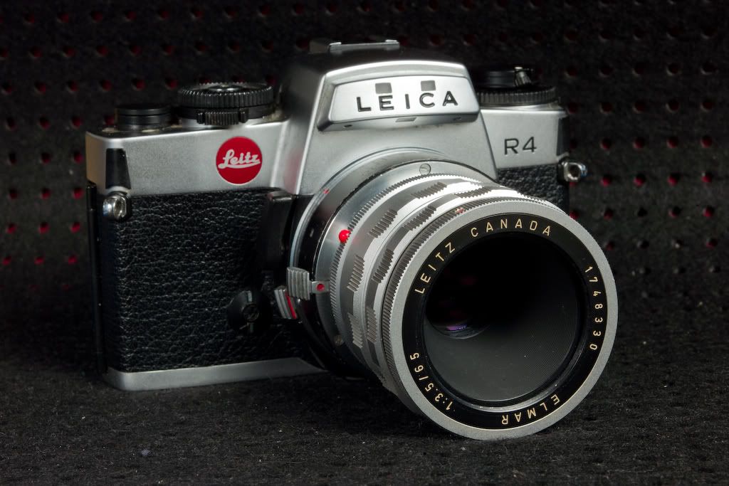

I use Leica adapter 14167 for using Visoflex lens on Leica SLR line cameras, and together with another Novoflex adapter EOS/LER I can use them on Canon EOS cameras as well. Besides TTL metering I can also use automatic exposure in these configuration; though there is no automatic diaphragm.

Time to bin the Viso, 'Sacrilige' I hear you cry but with a trusty 14167 and a Leicaflex SL all is beauty and light!
And an elderly SL is not a pricey bit of kit. (although SL2 is) The world of Viso and R lenses can be yours.
