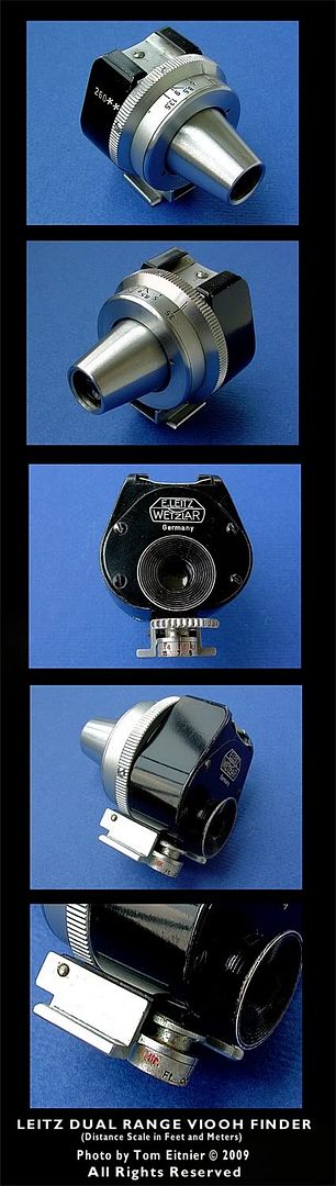

Here`s a neat little item I picked up over the evilbay a few days ago for a BIN.
It`s a version of the VIOOH Universal Finder that`s most surely been forgotten by most people, and I`m sure never mentioned here at RFF.
A "Dual Range" VIOOH with distance scales in Feet and Meters !
(note red and black numbers on finder base)
Meters in Red and Feet in Black paint, I`ve only seen this finder for sale anywhere in over 5 years, so I`m sure it`s pretty rare, and from the serial number #260xx it`s an early numbered one with the new 85mm markings.
I figure this was produced (ca. 1949 - 51).
Just WHY? did they stop making them this way with the DR we`ll never know?, but they sure would have been helpful for everyone who`s using mixed lenses. 😀

My Lyre-shaped VIOOH has both ranges as you say. Deteriorated optics in mine though and a small crack in the corner of one of the prisms 🙁
Yes, the VIOOH is easy to open and clean. The prisms aren't aluminized, you just need to get them clean. Remove the four obvious screws on the rear, and then the two that hold in the prism assembly.
They didn't bother to add serial numbers to the Lyre-shaped bodies as far as I know.

Rick, you just remove the bracket the prisms are on, and clean all the glass surfaces you can reach. Don't try and remove them from the bracket, you will never get them right again.
If the lenses in the front are clean, there's a more complex series of retaining rings and set-screws to deal with. But hazy prisms are the more likely fault.

I went to try cleaning mine, and muddled with the set-screw on the selector ring... it did not help me get the VIOOH apart, and I could not get the set-screw to thread-in again :bang: , so I put a piece of scotch tape over the set-screw, to keep it from getting lost, and put it away for another day.
Any suggestions on resetting that selector-ring set-screw, John ? 🙁
