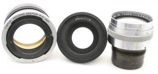

As a follow up to the F/A story, I'm posting a photo of the F/A itself, and the 2 different lens heads that I own. There you can plainly see that the heads just have the lens data, and no makers name on them. Seperated from their box, they could turn up in almost any batch of odds and ends.

Just a few pics of the three lenses I have in my collection. The 135mm f/3.5 is the only one missing. Will have to look at my instruction sheets over the weekend but I know there is start and cut of numbers when the lens head could be removed and fitted to one of these adapters. The 85mm f/1.9 lens head is the last I have on record and is close to the final lens Canon mentioned in there instructions.
Thanks, Peter, for the pics. It was particularly interesting to see the RB, as I now know what to look for, having never seen one of these before.
