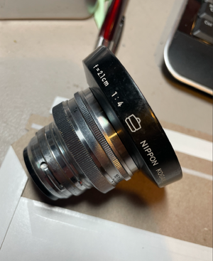

The 43mm lens hood above doesn't work at least on my 3.5cm f2.5 because mine is the black version (late) perhaps? I have it printed and the problem is the following. That hood has two circles at the bottom but the outer circle sits directly on top of the silver aperture ring and does not fit between the aperture ring and the name plate like it appears to do in the 43mm f3.5 in his prints.

Then theoretically I just need to design a hood just like his but without the outer rim/circle at the rear.
Hi! Please read the descriptions in my printables pages. As noted, that lens hood is designed for the earlier more common versions of the 3.5cm f/2.5. You have the late version which is identical to the barrel of the 3.5cm f/1.8, with a 43mm inner filter thread and 48mm outer hood thread. My hood design for the 3.5cm f/1.8 (or Alpsman’s) will fit your lens perfectly. Please let me know if you run into any issues!

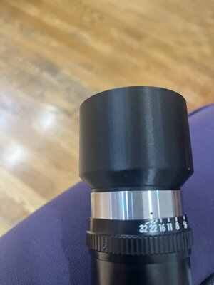

apologies for the late reply. firstly can confirm the late 3.5cm f2.5 works great with the hoods above - thank you. Also see attached to the 135mm lens. It's a bit longer than the original as my dimensions weren't perfect i guess but zero vignetting and works great. Thank you!

As far as I can see from your pix, that the thread is to long.
Does it fit correctly?
Is it hard to turn?
Your friend did print the thread with the lowest possible layer hight?
How long is the thread in the lens?
Otherwise I'll correct the length - Series production did not start now. ;-)
I just rechecked the thread of the 50mm hood which has the same diameter and pitch.
It is exactly the same as on your lens hood. So theoretically it should fit.
