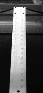

In this case it isn't the shims that are glued, it's the retaining ring holding the rear group of elements in place. Apologies if I was unclear.
In this case, I have 25 or thirty lenses of various brands that focus just fine on an M8 and one (the 50 M-Hexanon) which back focuses as I stop down (I said front-focus above -- incorrect as the attached photos will show). Attached are jpgs of the Hex at 2.0, 2.8, 4.0. Point of indicated focus should be on the "9" inch mark. Area of best focus is just behind this at 2.0 and moves backwards as the lens is stopped down. M8, ISO 160, handheld, FWIW. Silly, really, to take pictures of rulers, but there you are.
Ben
kevin m
It certainly helps to trouble shoot a lens that's giving you trouble, though, and it sounds like your particular lens is defective, in this case.
