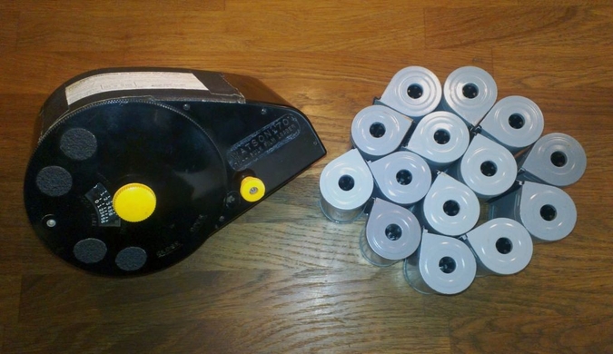

Hasselblad 70mm loader! Have it beside Alden 70
Anyone knows the Hasselblad 70mm loader? I have one. Film must be on spool not core. there is ZERO axis like in Alden 70 where there is also an adapter for different cores.
Alden 70-counter is better (no cogwheel like in HBs-no unperforated film possible). But i remove the Alden counter since i dont like metallic arm sliding over film. Must organize manual- hope seller has it. Images of parts will follow.
Hope its really Hasselblad or is it Watson? more imges next

Hasselblad 70mm loader- more images
it has a counter with cogwheeel, Unperforated films not possible. image of counter-mechanisme coming asap.
maybe someone knows how to use. one could imagine when seeing counter-wheel from closeup. will try to get manual from seller.

Watson and Alden 70mm loader are identical. Alden 70 was made by Queens City Plastics, they replaced a defective part for free, i dropped the loader.

complete images now
completely disassembled. counter is reliable. pull the disc out.

Never seen one of those before, it is not a Watson. I've got the Watson loader, here is what it looks like:

"Hasselblad?"-70mm-loader more details
Before having time to upload more images here some weird news.
The box with the 70mm-handle is onlky sticken ontop no screws nothing. it can fall apert when no film(donor) and loaded cartridge is mounted.
inside at the main rim there are traces of glue seller telling its from a tape securing whatever, film? box? film is inside and box is combined with second insert by 3 screws. one with a bolt. see images.
clear could be that without spool(film only on core) film will wooble around touchig the walls. Very bad decision of the designers not adding an axis. the alden has two adapter-options for the axis.
for unperforated film counter cannot be removed easily, maybe a dummy made.

In my opinion this cannot be from Hasselblad. i will ask them.

Watson=AldenNever seen one of those before, it is not a Watson. I've got the Watson loader, here is what it looks like:
To avoid the counter-lever touching the film i removed it and covered its hole with opaque tape. yes one has to find out how to rotate for certain lenghts. could be difficult if film is this or ultrathin PE0 e.g. 0.1mm like vericolor HC(100) can be loaded with 6.5m. technical pan may be same thickness.
Good are magazines which can be zeroed like Mamiya RB 67-70mm after 65 shots(if i dont err) to shoot more than the max.
When counter is dead(i have such an insert) zeroing counter after the max(in counter) was achieved is not needed. its by opening the door (in darkness). one could zero before reaching the end to avoid darkbag by shooting twoi empty shots and exposing that part to light when having to zero when counter is working. agfa has PEO thickness 0.06mm which would lead to real extralong film in 70mm cartridges. How thick is Technical Pan 70mm? same as 35 and 120 i guess.
