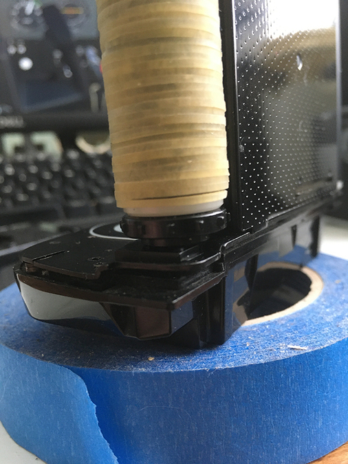

Well the RB67 70mm back came yesterday. Good news is that it drives the film via turning the spools themselves. If it's using the sprockets at all it seems to only be for the film counter (though I haven't confirmed that with film). My guess is that it might handle non-perf without mod and at most it would probably just be necessary to wrap that spinning part in an orthodontic rubber band (as has been suggested elsewhere) and all should be fine. Bad news for me is that the way my Horseman 842's Graflok 23 back is designed conflicts with the proportions of the back so I can't properly mount it. I don't see any avenues for modifying the back to overcome the issue unfortunately so it looks unlikely I'll shoot 70mm in this back.
I've still got the RH50 on the way which I can use with Graflok 45 cameras and maybe there'll be an avenue for custom fitting it with a Graflok 23 plate once I have it in hand. I'll also keep my eye out for a Hasselblad back as an alternative system for playing with 70mm.
