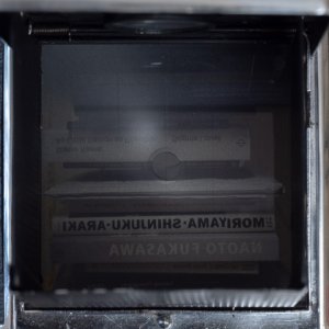

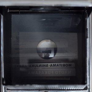

Speaking of focusing screens, my new bright screen arrived from PRC, so I wasted no time in installing it into my 500c. Initial impression ... Hmm. Stock screen has raised spot in center of screen. New screen has a split-image center which I did not order, and a grid pattern, which I did. To look at the photos (identical camera settings and lighting), it sure looks as if the original actually is brighter and has better contrast! But is that really true?
The answer seems to be "kind of" but there's a big catch: It's only true for one specific area, whereas much of the rest of the frame is all but impossible to see. New screen is much more evenly-lit when viewed from the same angle. And when I point the camera at a sunlit scene, the new screen certainly looks bright enough.
