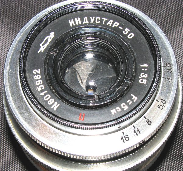

And a close up of the I-50 (1960)
I am not taking about the "Take-Up" spool, but the Rod or what ever it is called that the take-up spool slide unto to.
FYI..The I-26m is also 1960.
