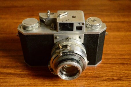

Does anyone recognise this camera , if not this specific camera but its styling ?
A 35mm rangefinder fitted with a Rodenstock Heligon 5cm f2 lens. The lens with its serial number dates tomid 1940s on into the 50s , the camera being made during or indeed after this period. Rangefinder optical system is unusual . Film loading is pretty standard but the rear door is opened by a circular button key to the back door itself -not to the baseplate as we have came to expect with most manufacturers .
This operates two prongs to the inner surface of the door - one goes up and the other down , both simply locking the door to the inner camera body.
Looks like a prototype fabricated as a pattern for a later manufactured model - but by whom , and for what ?

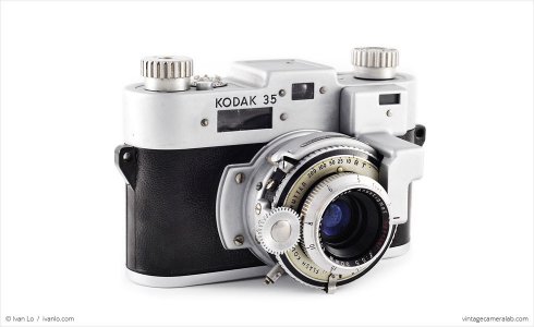

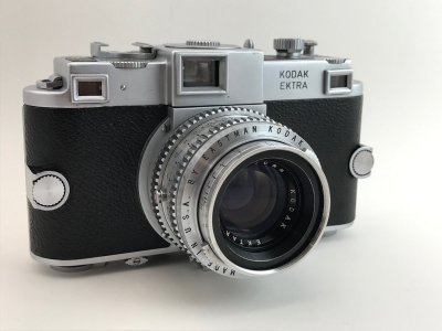

Thanks for the input . Yes agreed . it does look sort of chunky meat-loaf like Kodak ... have never owned a 35 nor Ektra but my Medalist does not win any prices for looks . The Rodenstock lens sitting in its , well a cradle of sorts, does shadow vaguely the look of the external lens assembly on the Kodak 35. The Release Button - unthreaded so no cable release . Despite this odd location , and because the distance from it to the grip ie where the palm of your hand rests to the side , you can manage to operate the button without blocking the optical path of the rangefinder . No flash shoe mount hankers back to pre-War cameras , yet the lens with a serial number starting with 2037 indicates post War 1945 on ( till about early 50s I think - sorry no nearly nowt about Rodenstock lenses ). As for film it takes regular rolls , no special ( ie early Leica /Robot ) cannisters
Wonderfully weird little camera .
Its cameras like this that put the fun back into photography !
Things like the klunky control levers make this look like a home made one-off, some skilled and enthusiastic machinist's pet project. "A high-powered mutant of some kind never even considered for mass production. Too weird to live, and too rare to die"
Looks like it shares nothing in common with a Kodak Ektra to me.

Overall layout is similar to a Kodak 35 RF, but since that camera was specifically designed to utilize the body castings of the previous non-rangefinder equipped Kodak 35, having a prototype with a completely different body makes no sense.
The shutter looks like a Compur Rapid which had flash sync added later, this shutter with the Rodenstock Heligon 50mm f/2 was a combination found on the postwar Kodak Retina II, so it's possible it was sourced from one of those, but other than that I see no Kodak connection.
What do the levers on top of the rangefinder housing do?
Nothing on the back or bottom plate? What is the identification on the front of the lens?

Does the top rangefinder come off? Some of those were accessory slip-ons. Try to remove it (gently, please, the thing is very old). There may be a name or details or even a serial number underneath. Or inside the camera. Somewhere there must be some info.
Also check the bottom plate for data. Surely there has to be a name somewhere. Or is the camera so worn that these have faded??

To me if a camera works it works - its eclectic origins can only add to the fun but yes I agree 'scratch built' does not do this little camera justice .
I have owned and photographed with some right dogs in my day but this is in a word just ' different '.
There has simply been too much work gone into this - specifically at the design stage.
The rangefinder is a work of art , albeit at the cost of not having a flash shoe .
Then the post-design execution - the machining overall , but particularly the rounded mirror housing by the advance wheel is superbly done ( with many small crafted parts / glass etc etc ). Sure , some edges are a little 'heavy ' and pre-market ready , some the smaller camera parts a little workmanlike , but overall ...
As for the finishing ?
The addition of the inscribed data to the raw unfinished ally bodywork -distance scale to the rangefinder , DoF scale to the body , f- stops to the lens cradle would be unnecessary in a scratchbuilt unit ie a camera made simply for fun as a project .
I also cannot see any amateur engineer taking the time to hand apply lettering and numbers.
It could be reasonable to suggest that this camera was built and then 'finished' in such manner to test out an idea ?
The lack of any manufacturing data ie a name or brand anywhere ( and yes I have looked ) would tie in with this .
A little task will be to ascertain under a microscope if the lettering has been stamped ( doubtful as no surface deformation to the surrounding material is evident ) , or applied by acid etching .
What are you talking about - the control levers are the cutest thing abut this camera ! 😁
On a serious note actually - although unconventional , they are 😎.
The lever on top almost looks like a manual frame counter except it has odd numbering for that. Stopping at 20 might mean it is a panoramic framing.

The progression of the numbering in that lever looks like metric distance markings to me. To focus the rangefinder.
