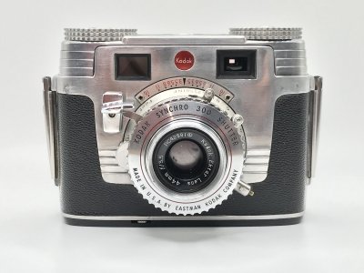

There are THREE optical windows - a la early Kwanon and Kodak . Not into optical theory but how and why dd some manufacturers streamline their rangefinders when others such as Kodak kept to using more glass than in the average greenhouse, as in ther 35 as illustrated by Hcompton79 earlier ? So when did rangefinder ' design' evolve to use less glass ?
The three optical windows ..... ? Why did Kodak follow this route so late in the day when others were managing to provide effective rangefinding capabilities with integrated finders requiring less glass and cost ?Looks like it shares nothing in common with a Kodak Ektra to me.
Overall layout is similar to a Kodak 35 RF, but since that camera was specifically designed to utilize the body castings of the previous non-rangefinder equipped Kodak 35, having a prototype with a completely different body makes no sense.
The shutter looks like a Compur Rapid which had flash sync added later, this shutter with the Rodenstock Heligon 50mm f/2 was a combination found on the postwar Kodak Retina II, so it's possible it was sourced from one of those, but other than that I see no Kodak connection.

Three optical windows would tend to indicate to me a split image rangefinder with a separate viewfinder. This certainly wasn't an unusual approach before and just after WWII, in fact it was the most common approach, with Kodak favoring it along with others like Argus, Perfex, Clarus and Leica doing the same. Leica was the odd duck out actually, using a separate RF and VF with three windows, but with the rangefinder was actually coincident image rather than split.
Before WWII, only the Contax II and III were using a two window combined coincident image RF/VF. I believe Kodak's first two window coincident image RF/VF was the Signet 35 in 1951:
By the way, fewer windows doesn't mean less complexity. It's often easier to build a simple rangefinder alongside a simple Galilean viewfinder than it is to integrate a coincident image rangefinder into the viewfinder, which then requires additional mirrors, or half silvered beam splitters which add to cost as well.
By the time integrated RF/VF assemblies with coincident image rangefinders start becoming common in the 1950s, you see a shift back towards three windows to add a diffuser window for projected framelines.

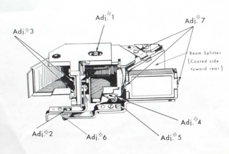

Oh, and lest you think two window rangefinders are always simpler. Don't try taking apart the rangefinder of a Kodak Retina IIIS. A two window coincident image rangefinder with automatic parallax correction and automatic projected frameline indexing for 35mm, 50mm, 90mm, and 135mm lenses depending on which is attached to the body.
One mirror, one half silvered mirror, four lenses (one of which has a hole bored through the middle), a diffuser sheet, two metal sheets with framelines cut in them and a menagerie of small levers to actuate it all.
Anyway, I now digress from this tangent and back to speculating about this interesting mystery camera.
