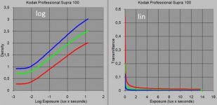

Film negative is already in some sort of real life based Log.
You can take densitometric curve, linearize and make Photoshop inversion curve for Photoshop in Excel. For linear part negative film is Gamma 0.6 in LOG space. If you design inversion software you use this curves plus contrast changing curves lik U-type (Shlick) and S-type (polynomials).

Below is negative film sensitometric curve (in log coordinates) and in linear coordinates. Second graph show red channel in linear coordinates and normalized LOG curve plus LOG+Gamma0,6 that approximates most negatives. Gamma 0,6 means contrast is lower to get more fstops latitude. Slide film is opposite - contrast is higher for projecting in dark room and this is what we need for HDR - put slide od light table.

Would be wise check Schlick curves for inverting negatives. You can approx linearize transmittance of negative film and adjust per taste. In Photoshop must be calculated via e.g. Filter Meister because curves are 8 bits. When you make RAW image try expose using native ISO near clipping on histogram.
