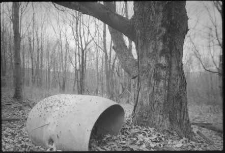

Actually, the Summicron-M 50mm lens will do a lovely job of digitizing negatives, presuming you have the right extension tubes, etc, to enable focusing at near 1:1 macro distances. As example, I grabbed a couple of random negs off a roll of ACROS 100 shot with my Minox 35GT-E around holiday time in 2023 and scanned them with the M10-M/Summicron-M 50mm lens using the BEOON copy device.
Sample Scan #1
Sample Scan #2
I rendered them quickly, about five minutes work in LR, so I wouldn't call them the best practices work, but I don't see any problems using the raw files I made with the M10-M and Summicron 50mm. :)

They are noticeably soft at the edges Godfrey. Don’t get me wrong, they are lovely photos, but is the softness from a lack of field flatness? I tried a Summicron and found it lacking. I like the Focotar-2 and large front element Focotar best for the BEOON.
I agree that they are soft at the edges ... My ancient Elmar 5.0cm f/3.5 is sharper at the edges, as is the Voigtländer Color-Skopar 50mm f/2.5. You are likely correct: a lack of field flatness. The Summicron and Summilux M-lenses were never designed to excel at 1:1 for flat field work ... BUT they can be used and can return nice results, depending upon the kinds of photographs you are trying to digitize. Not every photo needs super resolution at corners and edges, like portraits for instance. :D
Also, I pulled these negatives pretty much at random from a strip of Minox 35 negs. I have no idea what lens opening was used on the Minox for them, and some of the corner-edge degradation might simply be the Minox lens used wide open. They were not a precise test...
Of course, these examples were simply a test to see what can be achieved. I'm not unhappy with the results, but I would normally use the Macro-Elmarit-R 60mm, Macro-Elmar-R 100mm, or the Summicron-R 50mm (for high magnications near 3:1). My experiments with a couple of enlarging lenses didn't return results as pleasing to me as those three, but I've never had a Focotar to experiment with. :)
