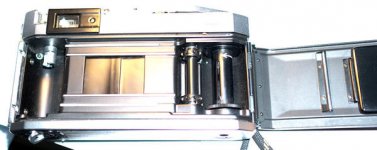

Thanks to everyone for the comments so far. Unfortunately, I am still not much further in resolving this problem.
I cleaned everything I could find to clean, but to no avail. I am 95% certain that the scratches are on the dull side (emulsion) of the film. Which means that one of my initial suspicions of where the paint is worn away, (see circle on attachment 1) is probably not the issue. This also probably means that the issue is not the pressure plate?
I've attached some shots of the inside of the camera. Can anyone see anything that I might have overlooked?
Thanks for any suggestions.

Put a section the scratched film back into the camera and check if you can detect anything likely to contact the film where the scratches are.
Also sacrifice a partial roll by winding on a few frames, but only rewind a section back into the canister to check whether it is being caused on the rewind
Thanks.
Yep, I've done the first part and can't see anything. I will have to sacrifice some film I suppose.
I suspect that it is indeed the rewind that is causing the issue. Which is a pain. I probably should just give it to a professional to try and fix.
If the scratches are on the emulsion side, try to see where in the camera contact with the film could happen. If you think the scratches are happening during rewind, maybe the film cartridge is shifting slightly in it's chamber causing the film to hit the body.
Jim B.
