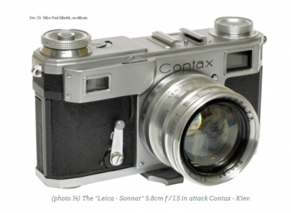

Is there any information on why these black market Sonnars are all 5.8cm lenses? From TenEleven's article it sounds like Zeiss acknowledges that these counterfeit lenses are in part based off of Zeiss parts/glass but if there was never a 5.8cm Sonnar what were these parts from? I would have thought it would make more sense for them to have produced 5cm Sonnars using parts/blanks for that Sonnar. These sellers would then not have had to resolve these various issues stemming from the 5.8cm focal length. Is the assumption that this is a marriage of Sonnar and 5.8cm Biotar lens elements/blanks or what? Are these just the obvious fakes and there were 5cm Sonnars as well that simply went under the radar because they didn't have such obviously 3rd party lens bodies?
dexdog
some people have hypothesized that these lenses were created from an optical-mechanical bombsight used on WW2 era German airplanes such as the Ju-87. I have links that explaining this theory on my home computer, but am travelling this week and do not have access.
lukx
The PDF provided by @TenEleven explains as much. It states that the lenses were bomb sights. Interestingly, the article quotes Zeiss saying the lenses were produced by others (i.e. not Zeiss) using a Sonnar formula.some people have hypothesized that these lenses were created from an optical-mechanical bombsight used on WW2 era German airplanes such as the Ju-87. I have links that explaining this theory on my home computer, but am travelling this week and do not have access.

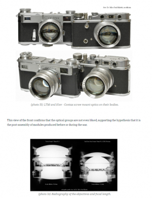

Since this has come up again, I guess I can share this. This is a relatively well known article by now - but I thought it would be nice to have a higher resolution version of it.
It's CZJ's statement concerning these 5.8cm Sonnar lenses. I finally managed to get ahold of the magazine and verify it's veracity.
I also made a high resolution PDF scan which I have attached to this post.
Relevant portions highlighted in red.
Räuber
some people have hypothesized that these lenses were created from an optical-mechanical bombsight used on WW2 era German airplanes such as the Ju-87. Try an internet search fot the term "stuvi"
This statement in this magazin from Carl Zeiss Jena is more of a PR campaign. From my experience I would say they only tell us half of the truth here. Let's get into it.
CZJ talks about the dismantling and about that some persons could get lenses (and probably machines and tools) in their hands. They blame those people that they started assembling those parts and lenses and sell them as CZJ lenses. They say that only those who calculated and designed those lenses know how to manufacture and assemble them. And they say correctly that you can not simply mix lenses from different lens types. They call those people bunglers and give no guarantee or service of those lenses.
The statement mixes things and not everything is correct. A lot of those unfinished lenses and parts ended up not in Germany but in the FSU. A lot of those (incomplete) Sonnar lenses where not finished on a black market but by KMZ in Krasnogorsk. I have some "fake" 5cm Sonnars that where build by Soviet workers. They seem to have started the production by simply assembling and finishing those unfinished lenses and train their workers with this. They got lens blocks where the name ring was engraved in Jena and manufactured and engraved the mount part in Krasnogorsk. This goes hand in hand what CZJ states about those black market lenses. But they are silent about the Soviet source knowing that they could not critique the new administration in the eastern part (where Jena was located).
There where some black market workshops in Jena and the eastern zone. They were hosted by ex-employees from CZJ. They made a living by crafting Leica thread mount housing of Contax lenses. There are some real Frankenstein Sonnars out there. But most of the time they simply got a new body with whatever scrap parts where available.
Then there is the mysterious German black market manufacturer of the Sonnar 5,8cm f/1,5. First this manufacturer did not only build the Sonnar 5,8cm but most of the "Fake" Sonnars. All lenses have one thing in common, they are engraved with the same font type as the later Opton Sonnars. The statement from CZJ has some holes here. They have stated that this 5,8cm Sonnar is made from a bombsight lens block. This might be true but there is no record of such a lens from CZJ today. It is missing in the Fabrikationsbuch so the production cards are missing. It is missing in the operation paperclip documents that were collected my the US military in Jena. Officially CZJ never produced such kind of Sonnar or developed one.
Sonnar lenses were very expensive lenses in those days. The reason is that it was very difficult to produce Sonnar lenses. They consist of 2 to 3 lenses that are glued into one lens element. You had to work very precise and clean to craft a Sonnar. Tessars on the other hand are simple to manufacture. Why on earth would someone pick a Sonnar to fake it? You can not simply put some random lenses into a metal cube and call it a Sonnar. We know enough about this 5,8cm Sonnar to know that it is a real Sonnar and no mix of Sonnar and Biotar lenses.
But how on earth could some random criminals get their hands on a pile of Sonnar lens blocks even CZJ have no documents about and sell them on the black market? For me there are only 2 candidates to pull this of.
Option 1 is Zeiss Oberkochen (Opton). They had the people and where geographically separated to the mother in Jena. Maybe they started a illegal production of Sonnar lenses in Coburg. People from Dresden might have brought the plans for the 5,8cm Sonnar to the Western Zeiss. The evidence might be the engravings that match perfectly the engravings of the later Opton Sonnars lenses.
Option 2 is Zeiss Ikon in Dresden. You might think that the Dresden manufactory was bombed but that is not totally true. The main manufactory was destroyed but there was a large outlet that was unharmed. Zeiss Ikon in Dresden manufactured the bomb sights. Zeiss Ikon in Dresden was the home of Ludwig Bertele (and his team) that had created all the Sonnar lenses before he left Dresden in the beginning of WWII. And there is one record of a test calculation of a 6cm f/1,5 Sonnar with a date from 1947 in the books. So maybe Zeiss Ikon wanted to be independent from the mother and developed and manufactured a 5,8cm f/1,5 Sonnar in Dresden Reick in all secrecy?
I imagine that CZJ knew who was the producer of the 5,8cm Sonnar but did not state this on purpose.

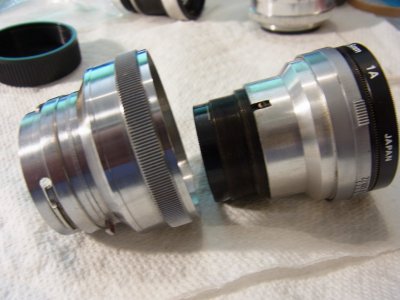

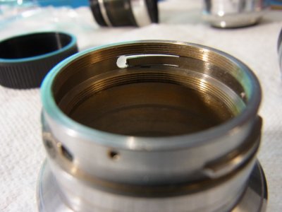

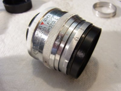

I received a very nice Transition CZJ 5cm F1.5, very clean glass- in Contax mount. I also picked up a J-3 in LTM that needed a thorough cleaning and some polishing. I have a transition lens made in the same batch as this one, but the LTM mount is "rough". The J-3 is much nicer. The lend picked up almost 20 years ago- unusable as the middle triplet was not fully polished. I had to replace it with one from a v4 Parts Sonnar. The new one- all original.
Why bother? I want a good transition lens to compare with "the real Zeiss lenses". From the article I wrote when comparing my Nikkor 5cm F1.5 with the wartime CZJ 5cm F1.5, "Bogdanovitch wrote of the Nikkor lenses “The lenses are of excellent color correction and perform better at full apertures than do Zeiss lenses.” Dr. Karl Bauer, President of Carl Zeiss, Inc. USA, was furious with the Times and threatened to drop all advertising with the paper. The Times allowed Zeiss to run a statement that the “Zeiss lenses being tested were not true Zeiss lenses.”
Why bother? I want to compare the Transition lens with my regular production lenses, and with the Nikkor.
There is a Famous B-17, "Old 666" that remains the aircraft with the most medals awarded for a Single Mission, including two Medal of Honors. When i saw the SN of this lens, immediately decided it needed to be converted.
I used the retaining ring from a ZOMZ J-3, as this lens had none. I polished the retaining ring down about 0.05mm, then used a 0.01mm shim. F1.5 came up to the index, and focus is good through the range. Transition lens made in the 1940s, J-3 made in 1973. Somebody had a standard for starting positions for threads.
