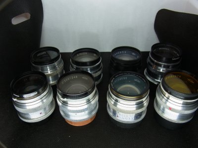

Sonnar Brian, I just counted 21 KMZ J-3s in LTM, one in Kiev mount . A total of 15 LTM 5cm Sonnars, including 2 that you converted for me years ago. Currently eight 1951 J-3s, I was buying them once upon a time to try to get an idea of where the serial number cut-off was for lenses with CZJ serials on rear group. I have been thinking about thinning the herd recently. I used to have two more 1951 lenses, but gave them away.

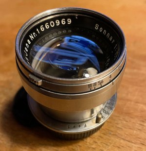

The 1.66mil Sonnars are indeed nice - I believe I have two? They do indeed have a interesting rendition. Not yet as bitingly sharp as the later, especially wartime ones. But at the same time they also do not seem to have any major vices. Very calm even keeled rendition - very flattering of skin tones imo.
Anyway one in Contax mount (post coated by someone) and and another uncoated one that some skilled machinist Elmar-ified. At least that's what I call this style of conversion. Basically - it's the simplest way to make a focusing lens on LTM - Elmar style. A bit rare is the fact that it's scaled in feet and only goes down to about 4'.

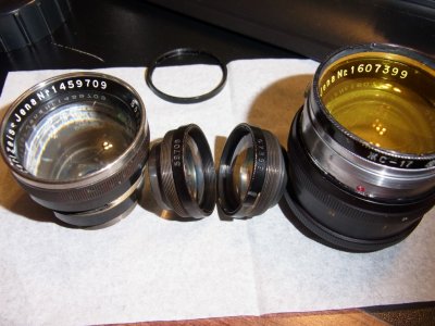

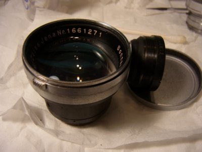

@TenEleven - are your 1.66mil Sonnars v2 with the small rear triplet, or v3- with the larger rear triplet and fixture?
1661251 is a v3 Sonnar, despite what the Zeiss production cards states. I believe that the switch-over occurred in this batch. A "Specifications Subject to Change Without Notice" type of change.

let me check.... let's see the one I just showed the glass from the rear (a bit of it is obscured by the retainer) is 24.26mm
The other one (digs in dry box)... is a 1660938 but it's finished black and nickel and chrome - the rear diameter is 24.24mm.
Also brian have you noticed that these have a weird striped pattern on their aperture? That seems unique to this (very short lived) series, too.
I also measured my 1754325 and the rear diameter is indeed a bit smaller at a measured 23.91mm.
Brian, my 166 series f1.5 Sonnar. Diameter of visible part of the forward-most lens element of rear group (exclusive of metal mount), is about 21.1mm. Edited because I am an idiot. Rear-facing lens element of rear group is 24.2mm
21mm? You mean from the back that faces the film plane?
And you measured the visible extent of the rear glass, right? That's so odd.
I got mixed up, tried to make a correction. The 21mm element of the rear group is the one that faces the front of the lens. The lens element of the rear group that is closest to the film plane is 24.2
@dexdog @TenEleven
Measure the Length of the fixture for the rear triplet, front rim to back rim.
The V3 in my 166x lens is 15.4mm;
The V2 in my 1607 lens is 13.2mm.

I have 43 Sonnar 5cm f/1,5: 2x RSBK, 3x KEF, 8x LTM / M39, 1x Leica M and a lot of Contax range finder ones. 2x Sonnar 5,8cm f/1,5. 44x Sonnar 5cm f/2: 3x KEF, 2x M27, 3x 551702, 1x Robot, 1 LTM and a lot Contax rangefinder ones. No Contaflex and Arriflex Sonnars. 🥲 I hope I can let them all go someday.
I suddenly feel much better about the number of Sonnars that I own. I've converted "about" 60 pre-war/wartime Sonnars to LTM using J-3 focus mounts, shot with all of them.

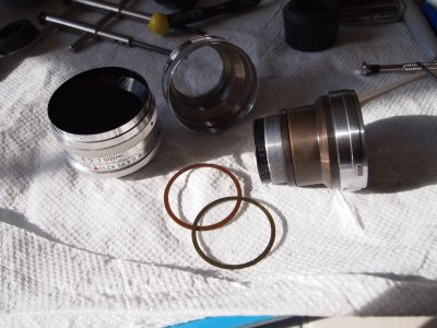

Where exactly is this variable stand-off ring? I have a post-war Opton/Oberkochen 50mm f/1.5 Sonnar that's front focused quite severely since I first got it, so it's sat on a shelf until I had chance to look at it. I didn't realise it was that easy!
Take off the Mount, one screw. Watch out for the guide pin falling out.
The variable stand-off ring is now exposted, and not locked into place. Figure 0.5mm per full turn. Mark positions, some trial and error.
