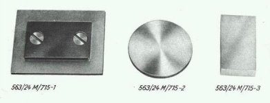

First I have attached a picture from the manual showing the tools used for setting the register.
I have attached another picture showing the set-up used for checking the register, and here is a rough translation of the instructions in the manual:
Alignment of the lens surfaces on the inner and outer bayonet must be made with extreme care. To adjust, a surface table with Fühluhr [dial gauge?] (1/100 mm reading) is required.
Before beginning the adjustment, put the gauge block 563/24 M/715-3 on one of the longitudinal cut surfaces of the support for the film plane 563/24 M/715-1 and set the dial indicator to 0.
Place the camera with open shutter (set to T) on the support 563/24 M715-1, put the bayonet to infinity and place the insert 563/24 M715-2 into the inner bayonet.
By placing shims 39 371 or 39 372 under the screw holes of the outer bayonet the lens support is to be adjusted so that when the screws are tightened well the indicator shows again at 0 (maximum deviation permitted +0.01 / -0.03 mm).

So from this, the method would work as follows:
1/ You place the first tool 563/24 M/715-1 on the surface table, stand the gauge-block 563/24 M/715-3 on the precision-ground surface of this tool and zero the dial-gauge on its top surface (from what follows you can deduce that the height of this gauge-block must be exactly 35mm).
2/ The camera is placed on the support 563/24 M/715-1 so that the rectangular section screwed to the tool locates in the film gate, and the film rails lie on the ground surface of the tool.
3/ You place the circular piece 563/24 M/715-2 so that it rests on the front of the inner bayonet, and set the pointer of the dial-gauge on to the front (top) surface of the circular piece. If the register is correct the dial-gauge will read zero, and if it isn't, you correct with shims as you would expect.
Thus the register is set from the front of the inner bayonet, and is equal to 35mm MINUS the thickness of the disc 563/24 M/715-2.
The attachment shows the diagram that illustrates this, and you can clearly see that the 35mm dimension is to the surface of the disc 563/24 M/715-2, not to the front of the outer bayonet. It is possible that the surface of the disc should, in fact, be at the same level as the outer bayonet, though there is nothing to confirm this. The diagram actually shows the outer bayonet as being slightly forward of the 35mm mark, though I suspect it should be slightly below it.
