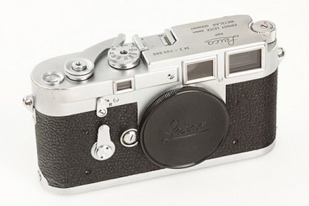

The Leica M3 1954 was widely hailed as the finest interchangeable-lens 35mm rangefinder camera ever made, the most advanced practical rangefinder 35 of its day, and the first new-from-the-ground-up Leica in nearly 40 years. The most significant advances in the M3 are a magnificent long base (68.5mm) nearly life-size (0.91X) combined range/viewfinder with true projected, parallax-compensating, auto-indexing frame lines for 50mm, 90mm, and 135mm lenses, the M-type bayonet mount, a two-stroke film-advance lever (later modified to provide single-stroke operation), and a hinged back section to facilitate cleaning, shutter checking, and film alignment. A translucent light-collecting window in between the rangefinder and viewfinder windows provides illumination for the bright, crisp white finder frame lines, and a frame line-selector lever below the front viewfinder window lets you previsualize the effect of mounting other lenses. But merely enumerating its outstanding features hardly does justice to this exquisitely refined machine. The integration of its various components is brilliant. It’s rubberized, 1-1/1000 sec plus B, horizontal travel cloth focal plane shutter is whisper quiet. Its contours mold seamlessly to your hands, and its shutter release, wind lever, and focusing mount operate with an uncanny silky precision. Within a few years, leading Japanese manufacturers, notably Nikon and Canon, produced splendid rivals to the Leica M3 with multi-frame range/viewfinders (see section below) and much more, but none ever equaled, much less surpassed the Leica in terms of overall excellence of design, particularly its superb range/viewfinder, which is yet to be natched by any full frame analog or digital rangefinder camera terms of focusing ease and precision. Perhaps the greatest tribute to the Leica M3 (aside from the legacy of memorable images it has captured) is the fact that it still endures. The current Leica MP and M6 are really nothing more than upgraded M3’s with additional finder frames and built in TTL metering, and the late, lamented M7 is basically an upgraded M3 with built-in autoexposure. And of course, all former and current digital Leica M’s culminating in the present top-of-the-line M11 are built upon the concept and features the M3 set forth nearly 70 years ago.
The Leica M3 of 1954 was a game changer that transformed the interchangeable lens rangefinder 35. I still lives in every analog and digital M.
The Leica M3, and its illustrious stable mates the M2 and M4 are all great (and now rather pricey) user collectibles selling in the $1,500 range in chrome (body only) in clean working condition (prices vary widely so check before pulling the trigger). The single-stroke M3 of the mid-60’s, with more rugged, durable wind and shutter mechanisms, a larger exit pupil for enhanced finder brightness, and serial number above 1,100,000, is especially prized (and more expensive), and early two-stroke models in average condition are more affordable.

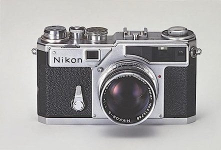

Nikon SP of 1957-1960 want head to head with the Leica M's. It had more finder frame lines, but it never really challenged the M3,M2, and M4.

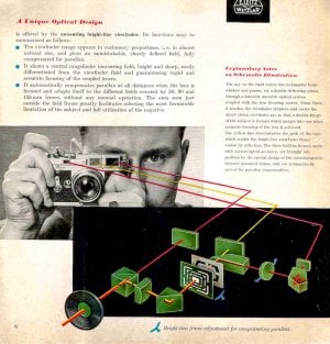

As the accompanying range/viewfinder diagram taken from Kisselbach’s excellent “The Leica Book” from the 1950s shows, the path of the light passing through the front rangefinder window passes through a solid double deflecting glass prism and is projected through a “telescopic element” coupled to the lens focusing system and into the viewfinder. The field frame illuminated by the central translucent window lies in precisely the same plane. The field frame and rangefinder images (rays) are simultaneously reflected by a beam-splitter into the viewfinder eyepiece where they are joined by the ray coming from the viewfinder, thereby producing a double image of the sighted object. By moving the focusing ring or tab of the lens, these images move closer together or further apart, and when the lens is focused correctly, they merge into a single image.
'50s brochure on the Leica M3 extols the virtues if its range/viewfinder with an excellent schematic showing how it works. Those were the days!
The focusing accuracy of this system is extremely high because the rangefinder patch is so clearly delineated that it’s possible to focus using the traditional coincident (superimposed image) method and also to use the areas above and below the patch to visually form, in effect, a split image rangefinder, that lets you focus by “reconstructing” a broken vertical or oblique line running through the viewfinder images and the rangefinder patch. In addition, the entire projected frame line moves laterally and vertically as the lens is focused to various distances, automatically correcting the parallax error that would otherwise exist between the viewfinder and the camera lens. Other multi-frame range/viewfinder systems (notably those in late model Nikon and Canon rangefinder cameras) provide automatic parallax compensation for a range of focal lengths, but none provide auto indexing, which automatically displays the appropriate frames when you mount a lens, and none is optimized for focusing using the split-image focusing method, claimed by experts to be about 5 times more precise than using the superimposed image (coincident) method.
According to the leading Leica repair experts we spoke with, the Leica M range/viewfinder system affords the following unique advantages:
1.The magnification of the rangefinder patch matches the viewing area very precisely.
2.The rangefinder patch is perfectly symmetrical within the frame line in use and remains centered when lenses of different focal lengths are used, and when the lens is focused.
3.Both the central rangefinder patch and the projected frame lines are crisp and sharp and appear at the same plane as you look through the viewfinder. Two thin pieces of metal provide the frame line parallax compensation for all focal lengths.

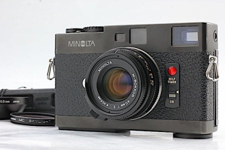

The Minolta CLE was best camera to emerge from the Leitz/Minolta partnership of the '70s, but Leitz never made lenses specifically for it.
The rangefinder base of the CL is 31.5mm and the viewfinder magnification is 0.60x, resulting in a small effective rangefinder base (EBL) of 18.9 mm. This is too short for accurate focusing with lenses longer than 90mm and fast lenses used at full aperture. The Minolta CLE does better, with an actual rangefinder base length of 49.6mm, a viewfinder magnification of 0.58x and an effective base length of 28.9mm. Both cameras display projected parallax compensating frame lines for 40mm, 50mm, and 90mm lenses. An analog Leica or Leitz Minolta CL body in good shape runs about $350 to $700; a clean functional Minolta CLE will set you back $500-$750, body only.

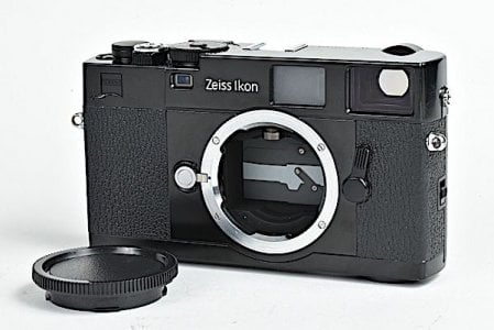

The Zeiss Ikon ZM of 2005 to 2012 (sometimes simply referred to as the Zeiss Ikon) is a handsome and fascinating M-mount rangefinder camera made by Cosina, designed with input from Zeiss, and compatible with M and LTM-mount lenses by Zeiss (or Leica et al). Its excellent range/viewfinder has a magnification of 0.74x, an actual rangefinder base length of 75mm, and an effective base length of 55.5mm, making it useable with a wider variety of lenses than the CL and CLE. It provides projected, auto indexing, parallax compensating frame lines for 28/85mm (simultaneously), 35mm, and 50mm, offers aperture priority autoexposure like the Minolta CLE, and the manual specifically cites and illustrates its split-image focusing capability. The ZM has one flaw which may or may not be fatal depending on your priorities—its rangefinder mechanism is rather delicate and easy to knock out of whack with rough handling or an incidental impact. It may be OK for general use but it's probably not the best choice for banging around on the trail. ZM’s are also not for the faint of wallet; a clean functional example in black or chrome runs $1,200 to $2,000 body only depending on the specifics.
Zeiss Ikon ZM, made by Cosina with input by Zeiss, is one if the nicest non-Leica M-mount 35's but its rangefinder mechanism is delicate .

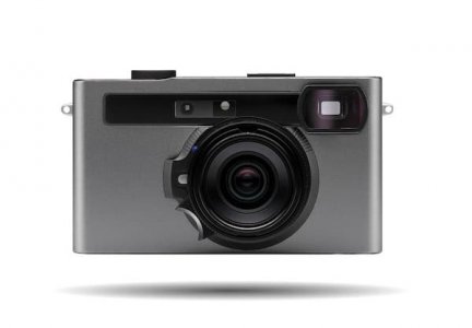

Pixii: Leave it to the French to come up with an offbeat but workable take on the M-mount digital rangefinder camera. Originally released in 2018, the latest 26MP APS-C sensor version of 2023 has an “interactive viewfinder” and a new 64-bit quad-core ARM Cortex-A55 processor with a dual-core OpenCL 2.O GPU with 768 threads and speeds up to 7G pixels/sec along with dedicated NPU and VPU cores. As a result, the company claims its latest model is the first color camera capable of capturing true monochrome DNGs and highlights the 64-bit processor’s ability to resolve finer details and create smoother transitions. Pixii claims the new camera can process images 10x faster than previous versions, provides three times faster transfer speeds and extends battery life by 25%. The Pixii has no EVF or LCD (other than a small back-mounted Status Indicator LCD) and is designed to display captured images on a paired device such as a smartphone. However, its optical viewfinder includes parallax compensating frame lines for 28mm, 35mm, and 50mm lenses, exposure indicators at the bottom. and a nice crisply defined rangefinder patch in the center, which is used for manually focusing attached lenses in the traditional manner. While not specifically mentioned in the manual both the superimposed image and split image focusing methods are clearly useable with this camera. An advanced an ingenuous niche product, the latest Pixii sells for $2,800.
Latest 2023 version the French made Pixii has a 26MP APS-C sensor, a 64-bit processor, 3 finder frame lines and a nicely made rangefinder.
