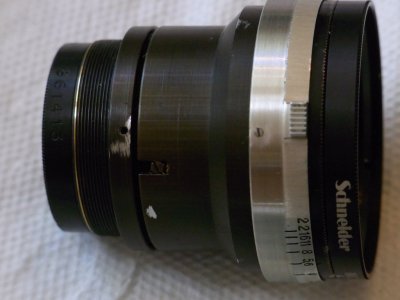

No, the first three digits of the CZJ serial number. The numbers stamped on the rear lens group fixture are normally the serial number of the CZJ lens, with the first digit removed. For example, my 1950 J-3 with zeiss components has 727386 stamped on the rear fixture, which corresponds to serial 2727386 for a 5cm/1.5 Sonnar as found in Thiele's book (i.e., it is a 272 batch lens)
Carl Zeiss Jena engraved every lens block with the serial of the lens. That is the number you can find at the rear end of the lens. But CZJ left out the very first digit of the serial. You have to guess it. But we know from experience that in your case the missing number is 2. So your lens has the Carl Zeiss Jena serial 2846266. I already included it in my spreadsheet.

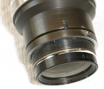

This just appeared on e-Bay and might be of documentary interest because the serial is showing:
I have looked at that lens, and I think that it is a true early J-3. The partial CZJ serial number stamped on the rear group looks legitimate, a nice clean and crisp rendering of the numbers, not like a few others posted on eBay that have numbers that appear to be engraved one way or another and do not look right. This lens also has the twin screws on the focus ring arrayed one above the other like a colon mark : Lastly, the number conforms to info in Thiele's book of CZJ lenses. I have a J-3 with a serial number 931 higher, or 5001032. My lens has a 272 series CZJ number on rear group. I think we may have to sic Rauber on the task of cataloguing the early J-3s with CZJ serial numbers 😉

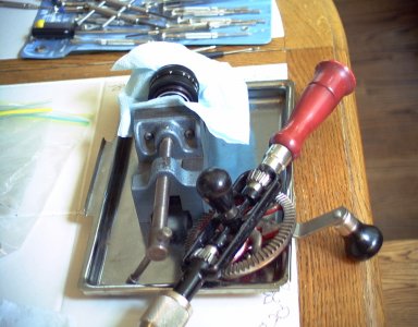

I suppose my J-3's come into the "Millenium Falcon" "She may not look like much, but I've made some special modifications". After decades of working on them, and picking up tricks like polishing down the inside of the Focus Ring using Fiber Optic Polishing Sheets, most are very smooth. I prefer the design of the Jupiter-3 focus mount over the original Zeiss LTM and ZK LTM focus mounts, the KMZ J-3 mount is especially good. Valdai mounts are all over the place, but I've learned to hack them into submission. Remember the Russian Astronaut in "Armageddon" beating the engine controls, "This is how we fix things in Russia"...tools_tray.jpgvise.jpg

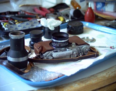

I have one Canon 50/1.5 that required more work than most. The rear group was missing, probably due to etched glass that affects a lot of Canon lenses.
So I used a spare rear triplet from a Nikkor 5cm F1.4 to replace it. RF coupled, had the get the spacing of the replacement rear group "just right".
Also learned the Shim from a J-8 can be used on the Nikkor 5cm F2 LTM... Good trick to know, picked up a Nikkor that was way off.
Another old J-3 from 1951. This lens is in Kiev mount, matte finish aluminum. Note rough texture above focusing ring. I will probably transfer optical fixture to a 1958 LTM mount.
This lens has lived a hard life. Luckily, glass is in good condition, although the front lens element has a lot of tiny pockmarks like it was pelted with sand. Not too bad, though
Collar above aperture ring is brass
