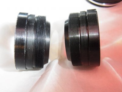

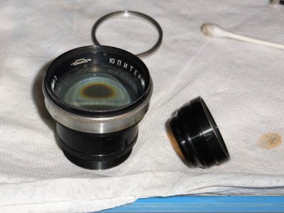

The partial CZJ serial number on rear triplet looks legitimate, and checks out against data in Thiele's book of CZJ production. Materials looks appropriate, blackened aluminum with a brass variable stand-off ring.
The lens is shimmed with copper wire, have not seen this before. Lots of scratched numbers on the fixture for the rear lens group, have no idea what they mean. Only partly visible in this pic, but looks like 33h=p44. I dont know how to type a cyrillic P, but the picture shows the symbol

I will test drive the lens after I swap it into the 1958 LTM mount. This is my first Soviet lens with a 286 series CZJ serial number. I have examples from the 284 and 285 serials that perform well once cleaned up and properly shimmed.

I got the optical block from the lens in post #160 into a 1958 J-3 focusing mount in LTM. The copper wire shim was much too thick at 1.32mm, the lens front-focused significantly. I looked through my small stash of J-3 shims and found a couple that together totaled 0.94mm, which is just about perfect for this lens. It passes the one-meter wide-open test and infinity focus is about 300 meters, as judged by some tall trees in my neighborhood, using google earth to estimate distances. Getting the proper shim in place left the aperture ring about 180 degrees out of kilter, will re-set it later. Gray and drizzly in my neighborhood this morning. Yeah, this is definately a Sonnar, and appears to be a decent one. One meter wide-open. Took a few more pics at f4 to confirm focus at known distances of 30, 100 and 210 meters, and the lens appears to be spot on. I think I will clean it after I rotate the aperture ring (a PITA job).

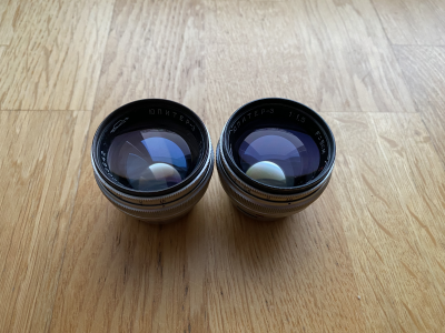

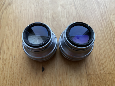

Got a new Jupiter 3 (1955). I was wondersing if Is it possible, that there's german reparation glass in there? As far as I know, 1954 might be the year, when the transition from german to soviet made glass happened.
Left one is from 1952 and right one is from 1955. The coatings differ a bit, rear lens block of 1952 J3 has no coating, 1955 has strong blue coating on rear lens. I have also a 1953 J3 and this one too doesn't have coatings on rear glass. 1952 J3 definetly has german glass although there's no number on rear lens block. I think that this 1955 J3 has recalculated soviet made glass, but who knows.

KMZ Jupiter-3 lenses with German Glass were made concurrently with the reformulated version through 1956.
You can tell by the shape of the rear fixture:
1956 ZOMZ on left, 1956 KMZ v2 on right.
German Glass KMZ V1- note shape of rear fixture is interchangeable with CZJ Sonnars going back to the V3, ~1935 or so.

Thank you, my 1955 J3 has v2 glass.
