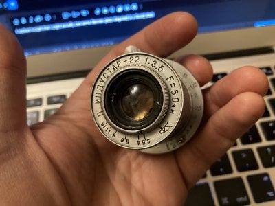

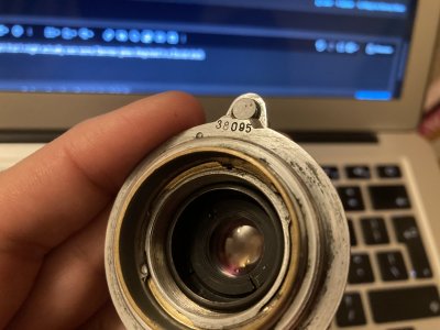

I realised tonight that I might actually own some German glass disguised in a Soviet shell:
I picked this lens up from eBay back in 2010 - it was rare to see KOMZ-made Industars (and still is, as far as I know), and the fit-and-finish and quality of this one was a lot nicer than the more "normal" 1955 KMZ Industar 22 I'd had for a while. It became my favourite Industar while I was still using FEDs and Zorkis, but the backfocusing when I started using Leicas drove me insane, so it sat in the original bakelite pot (which is lined with blue felt - something I've not seen on other ones!) for over a decade. Of course, that meant when I found it again, it was raddled with fungus. I'm an idiot.
Spent today cleaning it up, and more importantly, shimming it to the Leica standard, and holy hell, is it crisp. Here's the full frame of my test layout (sorry Brian, no fence posts here):
And here's two close-up crops of before and after the shimming:
But here's why I think it might be German glass:
According to SovietCams, this makes it a "PT5770", made in 1949 or 1950. Does that make it a Tessar in disguise? Were the Soviets already using their own glass for Industars by then?
It's probably a Zeiss Tessar, German glass and probably Zeiss elements.

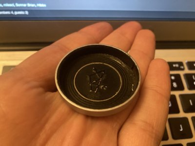

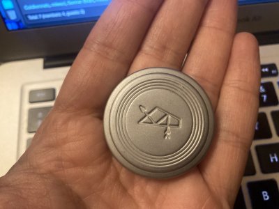

Intrigued by the above posts from coldkennels, I bought a KOMZ Industar 22 from ebay, pretty cheap in nice condition. I removed the lens groups from the barrel, no zeiss serials or parts numbers on either fixture, both fixtures are brass, nicely machined and well-blackened. All visible lens surfaces are coated. Number stamped on bottom of lens mount is 12227
Front lens group in fixture
