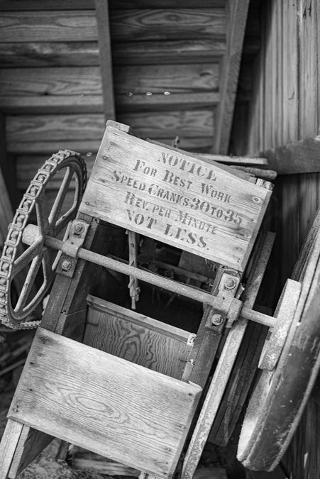

Thanks for the inspiring work. Here’s an example from a farm museum, M246.
I mostly shot black and white film with this lens, but it renders color and digital beautifully and gracefully as well.
