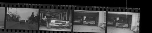

When scanning negatives sometimes I just want to scan the strip without having thumbnails. Problem is, when I do this the quality is much much inferior to thumbnails. How can I get the same quality as thumbnails without enabling thumbnails? What am I doing wrong?

Thank you for your reply. Im not referring to prescanning but actual scanning.
What I want to do is scan a strip of negatives as a single item to scan not as individual scans of each frame. So I turn off thumbnails. I click preview and it previews the strip. The quality is very low. Then I click scan and indeed the scan is just as low quality.
WHen I enable thumbs and the scanner scans each frame individually the quality is excellent. I want the quality of thumbs when scanning with thumbs disabled. I dont know why the quality is different, everything else is the same.
I scan like this quite a bit, the preview 'thumbs' are low quality you need to check you have your marquee round the image(s) you need to scan and your resolution must be reasonably high i.e 2400 rather than 72dpi
