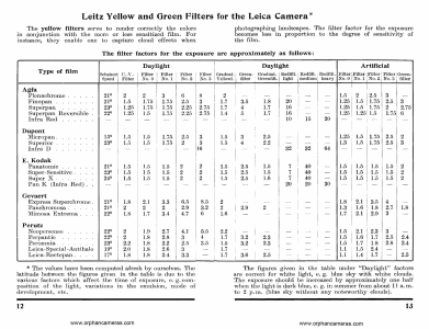

Digging through some old Leitz pamphlets on Butkus' camera manual site, I found this chart in a Leitz New York accessory guide from the 1930s:
Obviously, none of these films exist any more, but it does show how really the only way to know for sure is to do some testing and make some notes!

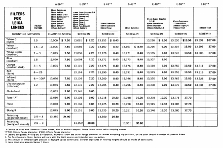

I did some digging and found this chart in a Leitz catalogue from 1964:
This might be the exact answer you're looking for, @F456 - Leitz themselves consider their GGr/Yellow-Green filter a "medium" and give a filter factor of 2-3, which is 1 to 1.5 stops.
