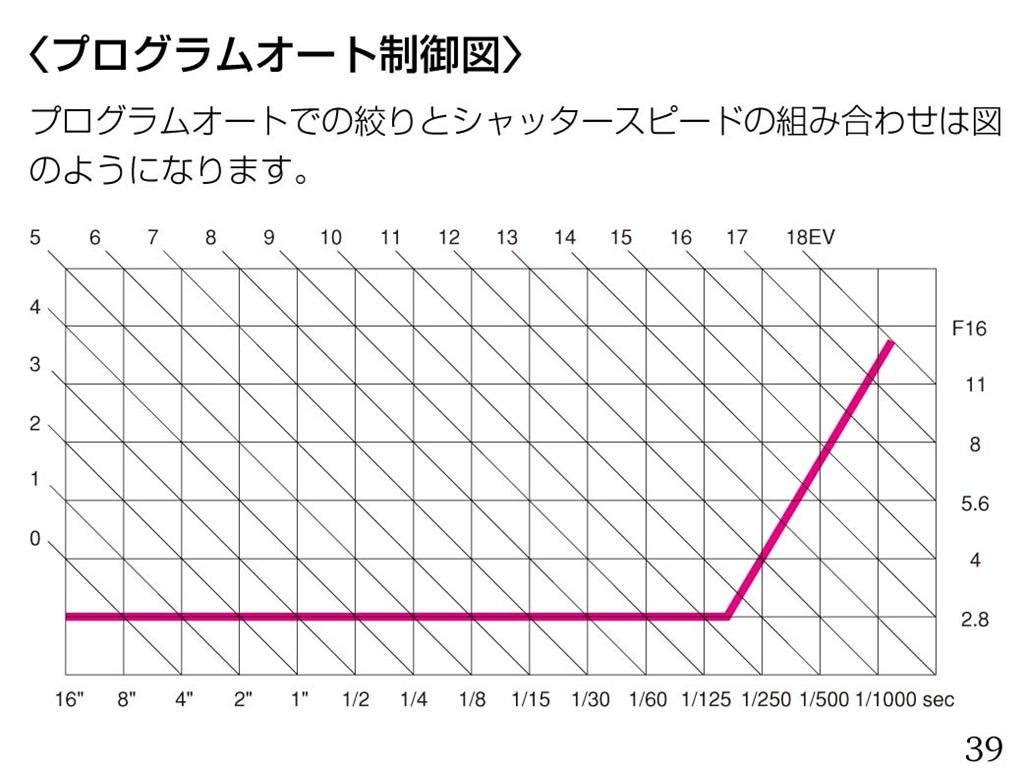

On point-and-shoot cameras with program AE only a f/2.8 lens is rather wasted - the f/2.8 will only be used in combination with the longest possible time.
mod2001
Old school modernist
The Contax T3 uses 2.8 in program AE mode until the shortest shutter speed (1/1200) reaches it limits for a correct exposure, so the limit depends on film-ISO and light conditions, the same limits you have with any analog camera.

Contax T3 program auto chart
sevo
Fokutorendaburando
No, it does not (see the chart) - but it has a rather unusual 1:2 time/aperture ratio and late start of the program range. Most compacts use a fixed 1:1 ratio of time and aperture reduction throughout their range, i.e. half steps each, like f/2.8@1/30-f/16@1/1000, and switch to flash (or - sometimes optional - long time exposure) where they run out of long range.
I've searched for such a chart for the Olympus mju2.
Does anyone know if there is one to be found ?
Thanks!
wjlapier
I'd be curious to know of a similar chart for the Fujifilm Zoom Date 2.8.
