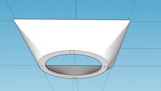

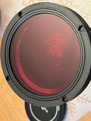

Building on this....
This is a friction fit over the barrel of the Nikkor 40mm. It has a stopper that prevents it from going to far.
The larger cutout is sized as a drop in for 95mm filters. (100mm diameter, 7mm deep)
The four holes are for magnets (delivered tomorrow) which will hold this is place...
.. which in turn holds the filter in place.
I originally made the hood round (160mm diameter) but it looked like it might hard vignette in the extreme corners so relofted it as a square hood. Printing now. Will also probably make a non-hood magnetic retaining ring to just hold the filter in place for when I don't want the hood.
Here is a quick movie showing it with the magnets installed.
Genius! I was shooting outdoors with that lens yesterday, and, if the sun was at anything less than a 90 degree angle, I got ghosting. I also have a kluged-together hood in the works, but it's not the elegant design you've created.
