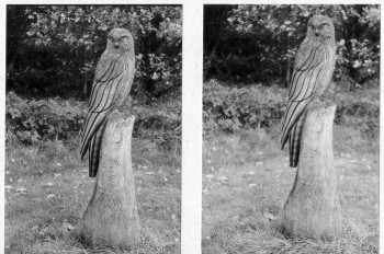

Frame 7 on the right, frame 8 on the left:

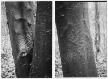

Frame 27 on the left , frame 28 on the right:

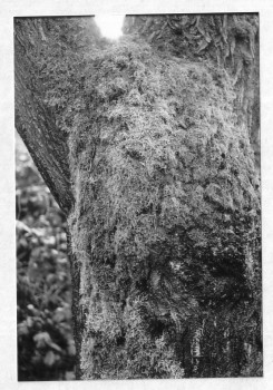

Frame 24:
Notice how the black band on frame 8 is thicker than on frame 24 but on frame 28 goes thicker than it was on frame 8.
I know what your thinking about the frame numbers:
"black band on 'evens', no band on 'odds'."
I've just checked that, and unfortunately it appears on frames 3, 15 and 21 (as well as some other frames) on this film. It also appears on 'odds' and 'evens' on the other film.
I tried scanning the film but I couldn't get any usable results as it's an old print scanner and I've no idea how to properly scan film with it.
I quite like the 'wet look' of frame 27 even though it wasn't raining and hadn't done so for a day or two.
