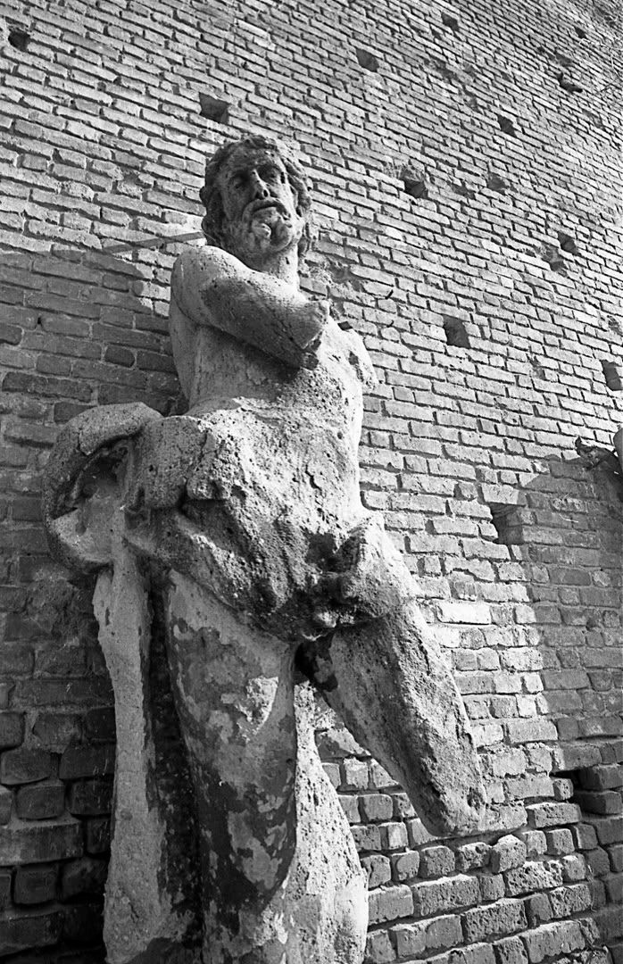

from my first self-developed roll with CV 21mm
spiderfrank
just a dreamer
7:58 AM
Apr 8, 2007
567
Savona (Italy)
Bessa r, CV 21mm f4, Ilford fp4 plus 125 iso, Ultrafin plus (6 min)
This is my first serious attempt to develop the film, and my second roll with the voigtlander 21mm, all the photos are shot in Milano, at the "Sforzesco" castle.
Thank you for your tips and comments
Franco
Not bad for the first roll. Never have used FP4+/Ultrafin plus myself, but I would have expected something less grainy. Are you maybe agitating too much/too rough ? Overdevelopment seems unlikely with 6 minutes the Massive development Chart gives.

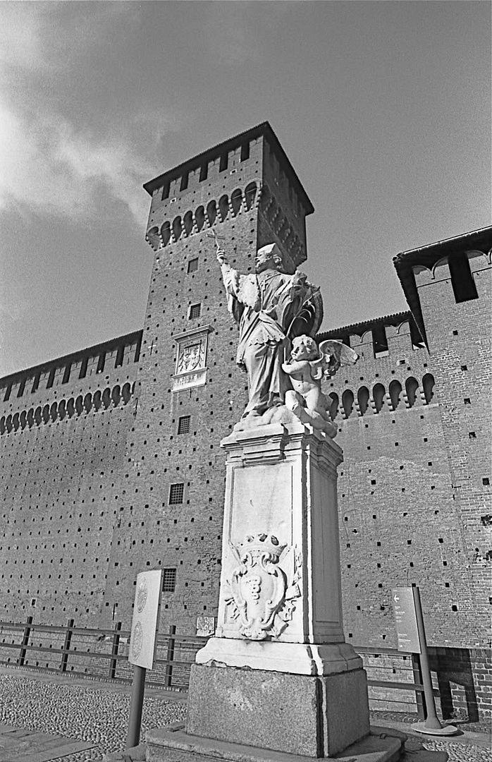

It's possible this is symptomatic of all 21's and I apologize if it is so, but I'm noticing a similar softness that has been surprising. Definitely shooting at hyperfocal yet so no far that I'd be getting diffraction. But it's not a sharp as my 15 nor as my other, longer lenses (35 and up). It's a nice FOV but not as sharp as I'd like. Your thoughts?

Thank you all, I expected it to be less grainy, but i didn't know the relation between agitation and grain, next time I'll be more quiet! (thanks Peter)
About the sharpness, I'm waiting for a roll of slides, to say something about it, here we have two variables: new lens and first develop... Not a good way to do experiments ;-)
I don't know what your agitation sequence was, but you might slow it down. Try GENTLE agitation once per minute, at the most once every 30 seconds, but do it gently, don't slosh it about. Also, make sure your developer is exactly 68 degrees (fahrenheit).

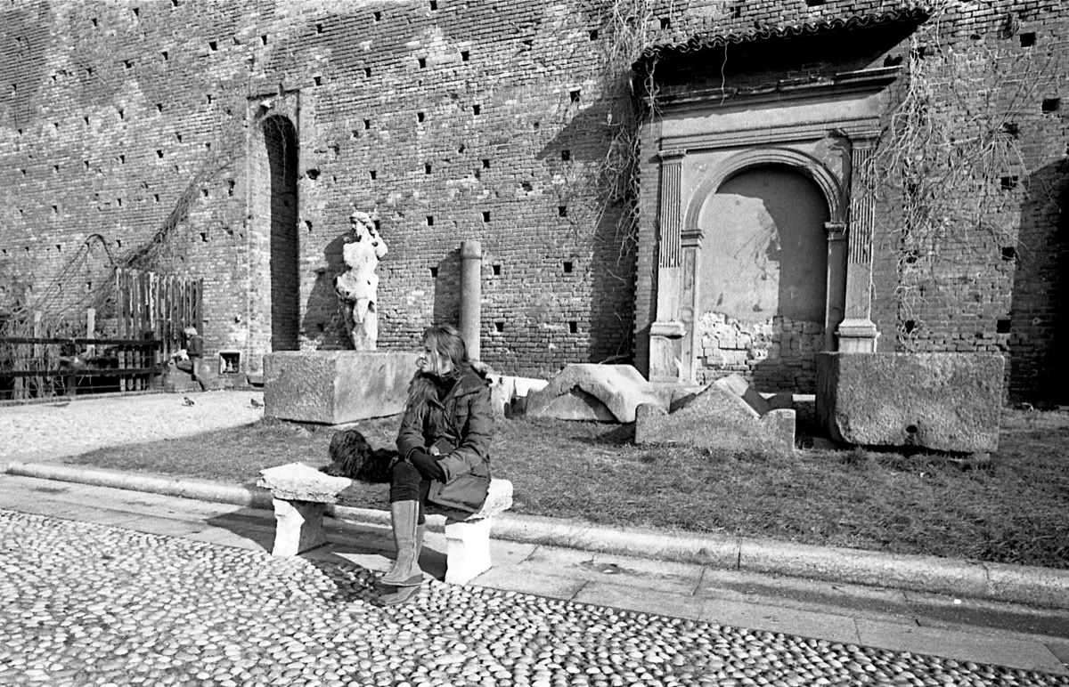

Nice photos for a first time around. I like the one with the girl in the foreground also, puts things in perspective.
Spiderfrank, nice first effort. What sort of dev. tank are you using? If it is a Paterson type & you are twisting the reels, try 5 gentle twists every 60 sec. If small stainless tank try 5 inversions every 60 sec. and keep temperature as close to 20c as possible.
