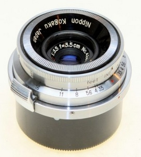

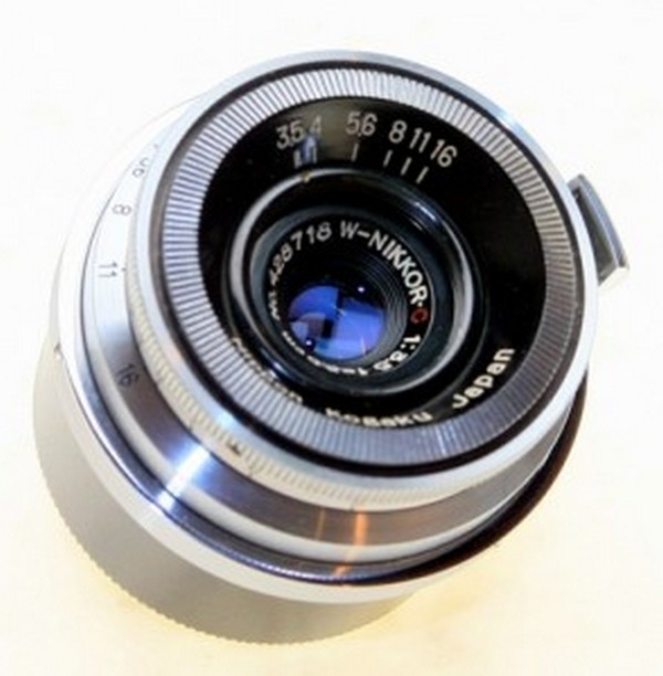

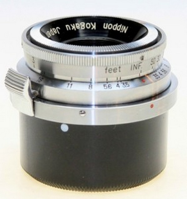

Can anybody tell me about the thread size I should look for the :
Nikon 35/2.5 & 35/3.5.
Do I need a vented hood or some said that there is no need of attaching a hood since the lens are deep-seated & surrounded by the barrel. BTW, what about for the UV lens ?

Those 2.5 and 3.5 Nikkor lenses take 40.5mm filters. I believe that the 1.4 needs a 43mm filter. The original Nikon hoods weren't vented. People got some great shots even without being able to see the corner of the image. Vented hoods get bent out of round more easily. Nikon had some pretty sturdy hard coating on those lenses. I wouldn't bother with a UV filter. With recessed lenses you probably don't need a hood either, unless you put a filter on the lens.
The S-mount 35/2.5, 35/3.5 and 50/1.4 all use 43mm filters. The thread pitch is 0.5mm, not the 0.75mm used on modern lenses. Before you buy a hood from Heavystar, confirm that the thread pitch is 0.5mm.
