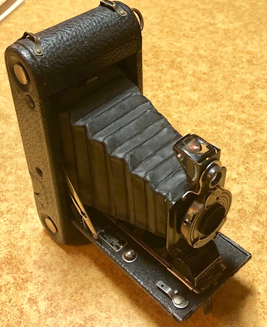

Yup, waited a year for today! Let’s see your 116 Cameras and images! My Autographic has been a genuine user and winner of photo contests. Mid ‘70s I got my 116 film by finding little mom and pop drugstores who had the stuff on the shelf for decades.

That is a seriously cute camera, Vince!
