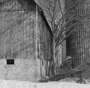

OTOH, I mostly only use Ilford XP2 Super 400 in my Rolleicord III & my Super Ikonta 645. It's extreme latitude (the tech sheet says it can do EI 50 - 800 and I agree with it) combined with being C41 so that it doesn't matter what I have to shoot any part of the roll at, just process it normally, gives me what I need. The lab does the work, I get my scans and pull them into Another Raw Therapee. That's fine for me as I'll never have the money for a scanner much less a darkroom of my own again.
This is probably not what most people posting in this thread would want to do, I'm sure 🤣 But I like what I get out of the process:
