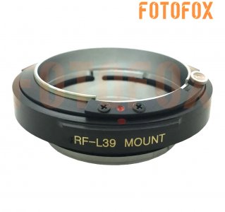

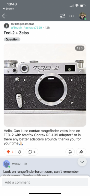

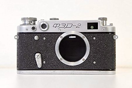

Welcome to the forum. There are better adapters- but cost Six times as much.Hello. Can I use contax rangefinder zeiss lens on FED-2 with fotofox Contax RF-L39 adapter? or is there any better adapters around? thanks you for your times
I moved your post to this thread, which is specific to the adapter.
Using this to adapt a Sonnar to a Fed or Zorki: I tested my adapter with a Zorki 3M and it worked.
The RF Cam of the adapter is thinner than a J-8 and J-3, but is placed in such a way that the RF pickup of the Zorki picked it up. This is not always true of using lenses made for a Leica on a Fed or Zorki. For example: the Nikkor 5cm F1.4 jammed on the RF pickup, but the Nikkor 5cm F2 worked correctly.
GeorgeRazmadze
Thank you for your time and help. Which adapter you used specifically?
I used the Fotofox adapter- the same one you posted the image of.Thank you for your time and help. Which adapter you used specifically?
I've bought 5 of them. Cheap enough to dedicate to some favorite lenses.

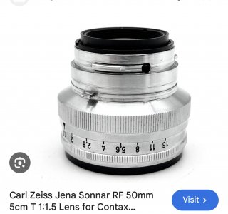

Why not use a Russian Jupiter-8M or Jupiter-3? If you're gonna use a FED-2 these lenses will work well with it. And they are Sonnar lenses - with the early ones made from the same tools that Zeiss Jena used.
Yes, there are some samples that have been messed up - or never worked right in the first place, but that is true for vintage Contax lenses as well so you're not escaping that either way.
Also, just FYI, the picture says "Jena T" lens when it's very clearly a Carl Zeiss opton (west German) lens. Beware of fraudulent sellers. Jena (east German) lenses are often worth more so they like to "acccidentally" mislabel Carl Zeiss Opton lenses (which are still good!) as Jena ones. They however look very different and also render quite a bit differently with the Jena lenses generally giving a more "vintage" look.

I have bought 3 from this seller:
and 2 from this one:
I suspect the latter are "seconds", I had to polish down the RF cam on one of them "slightly". I did not mind- meant I could adjust the Cam and not the lens.
The other one- perfect for my Nikon 5cm F2 on the Leica.
RF-L39 Adapter For Contax Rangefinder CRF RF Lens to Leica Mount SM M39 L39 | eBay
- With This Adapter, You Can used Contax Rangefinder CRF RF Lens on Leica Mount SM M39 L39 camera body. - Although the lens will fit physically, automatic diaphragm, auto-focusing, or any other functions will not operate correctly while using this adapter. - Infinity focus is guaranteed. -...
www.ebay.com
