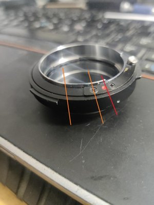

So I got one of those cheaper adapters, and it seems to focus past infinity on the rangefinder patch. Comparing on digital, it is doing the same thing too. Going to need to see how it looks at infinity on my Canon L1. I'll have to mark where the adapter is at infinity on digital and on the RF and see how close they agree with each other.
I tried it on my Sonnar 1.5 and 2.0 and they mount without issue. Have two Jupiter 8M's. One jupiter 8m won't seem to mount on it, like it gets tight well before it catches to "click" into the internal mount. The other mounts without issues. Sucks, the one that doesn't mount is optically in better shape.
Been trying to see if I can adjust the adapter, but I can't seem to adjust it to have an infinity hard stop.
On the external mount, I also bought a good condition black Jupiter 12 on ebay and it mounted as a test, but the RF cam doesn't move. Kind of moot though, I have enough 35mm lenses in LTM. Jupiter 12 + contax to LTM adapter + Sony E adapter + APC body, the smaller sensor'ed body won't clear the rear glass element
If the actual focus at the hard infinity stop is accurate and the problem is the adapter focuses past infinity using the RF: you can polish the RF Cam of the adapter down slightly. You need to trial and error- 0.02mm makes a difference.
I think at the infinity hard stop, it is focusing past infinity. I did mess with the setscrews, which changed where the lens sits, not sure if that will impact anything...Crappy cell phone picture and rough estimations, but the hard stop is the approximately at the red line, the infinity via rangefinder on two different Ltm bodies (Nicca Type III and Canon L1) is the orange line. And the yellow line is what the infinity is via the the Contax + LTM + Sony e mount adapter.
I still need to check via focusing screen/ground glass, but I feel like the last time I tried to check that way, I had a tough time seeing infinity with a loupe. I don't think there should be this much variance at where infinity might be?
