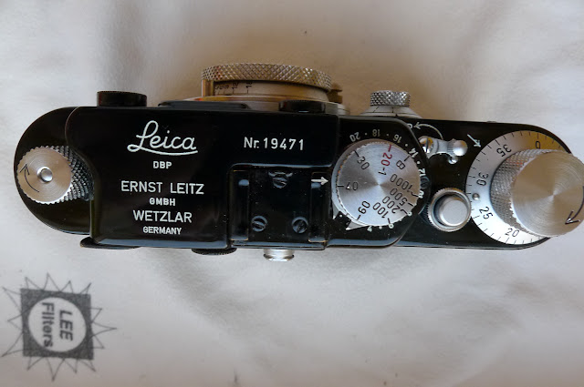

Hi Erik,
All four post war. I note that post war dioptre levers do not have the 'return' found on pre war cameras or conversions.
(They all have the raised accessory shoe and top moulding)
The more you look, the more you notice. I've never seen another IIIf style advance knob with film type on a IIIa syn.
Only the syn cameras go to 1/1000 but you can find 1/1000 on pre war conversions to IIIa.
Michael

"I note that post war dioptre levers do not have the 'return' found on pre war cameras or conversions."
My literature (Leitz spare parts list) states that only older II models without enlarged image had the plain eye cover glass.
"I've never seen another IIIf style advance knob with film type on a IIIa syn."
The same literature states that the IIIa syn has the winding knob with the film type reminder.
Great pictures, Michael, very informative. Thank you very much.
I guess that not two conversions are identical. That makes them so very interesting.
Erik.
