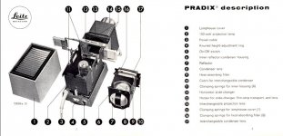

Got my Pradix manual yesterday. Attached is the product description page from the manual. I didn't realize the condenser lens is supposed to be interchangable if you change out the main lens as well. They are a matched pair. I now know all the names of the various optical elements.
In addition the manual states the Projection Lens and the Condenser Lens are both coated.
