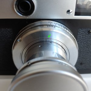

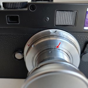

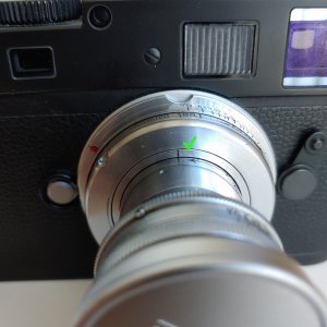

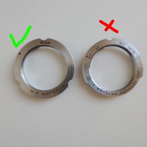

I think I sorted out where the problem is, it's in LTM to M adapter I used. I attached the lens to LTM body and noticed that black mark indicating lens retraction is in position "noon" but on my M body it's slightly offset to the right, that's the reason I had to turn it tiny bit backward to compensate for accurate focusing. Nothing is wrong with LTM to M adapter it's just the case with this particular Summar 50mm, this adapter works fine with all my other LTM lenses. So I found another Japanese LTM to M adapter for 35 frame line and as you may see from the picture it's in "noon" position now and the problem is corrected. I also checked the lens on Sony full frame mirrorless just to make sure the lens itself is ok and all images I took were fine and tack sharp. So the problem was in LTM to M adapter for this L39 Summar 50mm

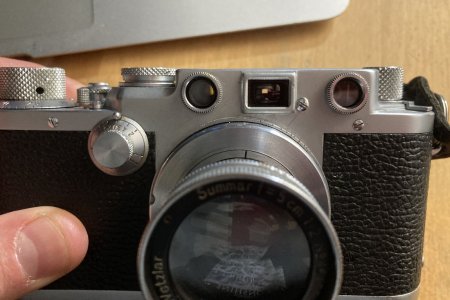

Here's where the Summar mounts on an LTM Leica:
Notice that the orientation matches the position of the lens using the Leitz-made LTM adapter in the photos above. This is the intended position of the lens.
But also, look at the back of your Summar - it's got a complete rangefinder cam (i.e. not a tongue-shaped partial one like a 135mm Hektor), and the cam isn't "shrouded" or partially blocked like the one on the 35mm f/3.5 Summaron. What this means is that rotational alignment actually doesn't matter with the Summar; it could be mounted upside down and as long as the flange-to-film distance is correct, it should focus properly using the rangefinder.
What I think is happening here is that the Leitz adapter is correct (as proved by it working with other lenses), but the Japanese-made adapter has precisely the wrong thickness, and this is compensating for an issue with the lens itself.
