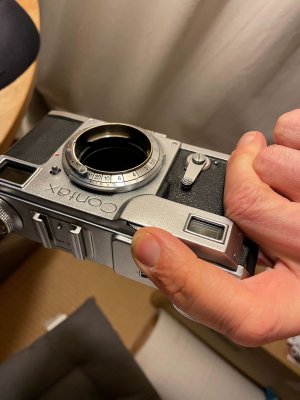

Edit, some image content. I repaired three of these - where two of the II's had their rangefinder purposefully misaligned - someone changed the RF gain (increased the gain - aka RF indicates closer quicker) so that they could use their Nikon lenses on these. They of course also took out about 0.03mm worth of shims. What the heck. The last one simply needed a clean of the finder.
While we are at it, how do you grip the damn thing to keep your finger out of the RF window?
(I say "damn thing" in that it's bloody frustrating when the patch vanishes - everything else is no worse than any other 1930s camera I've owned!)
Behold the Contax grip!
(The IIa is admittedly better in this respect - but I just love that pre-war and war-time goodness. Luckily I was gifted with long very flexible fingers.)
Edit removed image of holding it extra awkwardly because I was holding it one handed - in shooting I hold these two handed of course with a strap around my neck. Sometimes even two of them.

Thanks - I'll give that a go when I pass the cabinet later - mine are short and dumpy, but got to give it a go!
ETA - I suspect its a bit more comfortable for you, but I can do that. I'll have to practice before the next roll.
I somehow never noticed that. I just checked and you're right. But I had to consciously focus on what my finger was doing to notice it. I guess it's just natural to me either way?
I also sometimes use LTM cameras, so I might just be used to focus direction confusion and adapt without having to think about it much.
