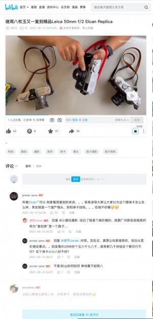

I met many Chinese photographers online, majority of them unable to see sites outside China, these who are able to use VPN can browse sites out of China, which is illegal in China. Here is screen shot he sent to me from bilibili.com, a replica of YouTube. The guy seems an official LLL marketing person. The comment section are kind of unfriendly
the first one said “ for God’s sake, please do not link it with Leica name it is just a domestic made lens
the second commented: it is plagiarism just like these who sell fake watches in GuangDong which claimed they are replica
the third: initial price $500 then overhyped to $700, 800, 1000, if in that price range why just get Zeiss or Summaron
The fourth: I simply look down that brand
the fifth: I can not believe what they asked for such a crudely made wannabe copy
well, Rayt or these who understand Chinese may able to confirm or give better translation.

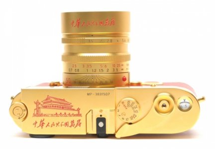

yeah... I was thinking gold Leica for my retirement next month...
But I think will go with a Zf instead.
I have a Leica M3DS, going by the SN, made the same month I was born. I did buy a red soft-shutter release for it. It was cheap. Too Tacky?
