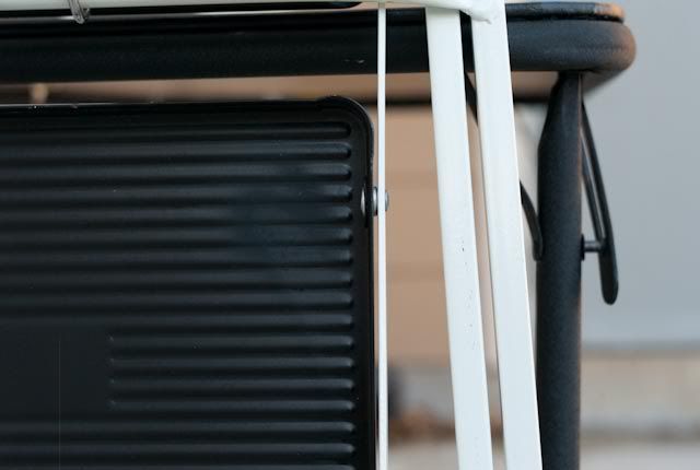

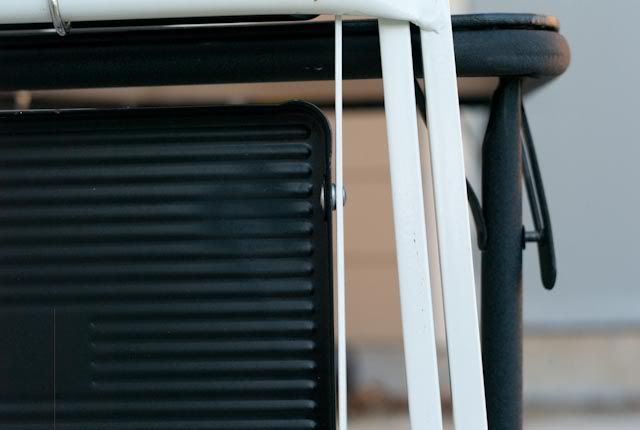

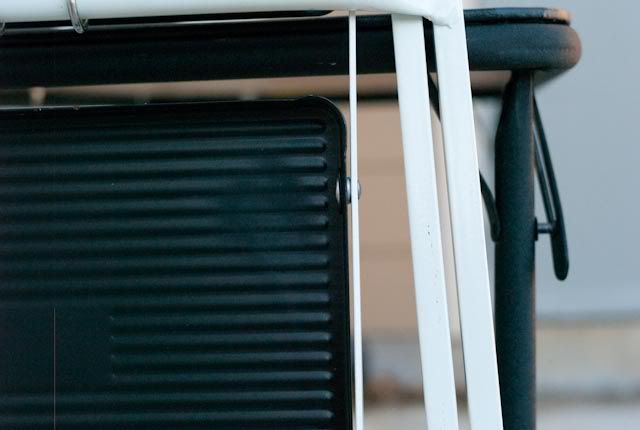

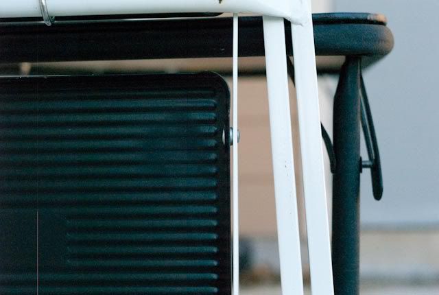

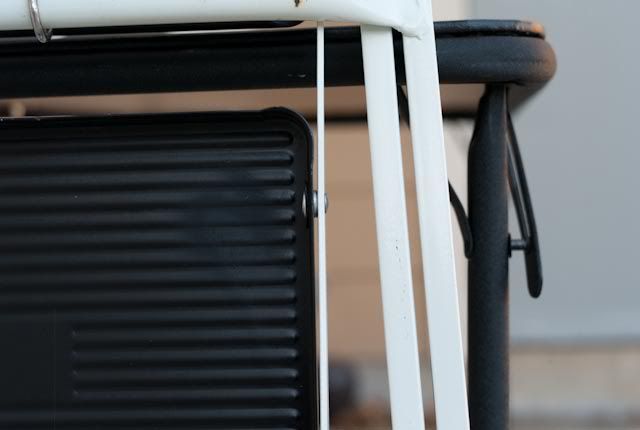

Hi. I just received my used M8.2 from an online dealer and noticed that there are vertical lines in the bottom left of each of my photographs. The vertical lines are visible in DNGs and JPGs throughout all ISOs.
I knew this was a problem with the earlier M8s but thought that this issue had been worked out since the M8.2,,,or am I mistaken?
I have the latest firmware.
I've included pics from 160 and up.
Is this something I send should in to Solms, or send back to the dealer for a refund?
