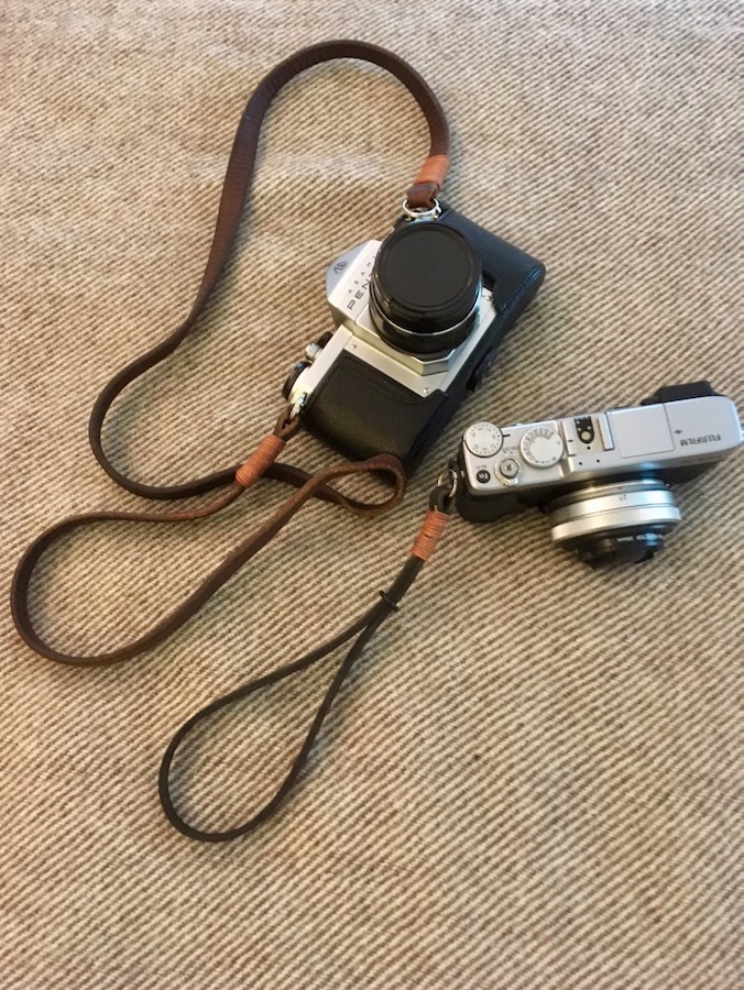

I like to make camera straps from used leather goods. It adds patina and suppleness. The two pictured turned out quite well. I modeled them after Gordy designs. The first bracelet I made was too big. The one shown is 8in from ring to loop, so twice that in length. At 3/8in the leather came from a cut down woman's belt. I like small split rings that just fit. In this case 1/2in. After searching around fancier craft stores and sites, it turned out the best quality came from a locksmith's store. It's just a decent quality key ring. I used "O" rings as a guard and as a smuggler. That idea came from Gordys.
The long strap was a dog leash cut to 42in. It's 5/8in wide and a bit thick, but OK. The ring is 1/2in. It's just right and has a sentimental meaning for me, which makes it special.
On both, I used a simple leather twine wrap to cover my messy stitching. The ends are adhered with contact cement and heavy thread hand stitching. I don't have leather tools, so holes and edging aren't perfect. For edge work I used a block plane and wooden screwdriver handle.
You could finish with a saddle soap or special rub, but I used bees wax gently melted in mineral spirits over a double boiler. It solidifies and lasts a long time. As added bonus, it's food safe so if you're crafting skills lead to cutting boards and wooden spoons, your good to go.
