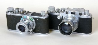

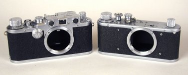

Vic -- My Zorki 1 has had the rangefinder removed. The first picture below is what a complete Zorki 1, with a rangefinder, looks like. I've taken a camera made in 1951 and modified it to be similar to a camera made in 1931 -- the Leica I. (Forward! Into the past!) The original Leica didn't have a rangefinder. In 1932 they added a rangefinder and called it a Leica II, see the second picture below. The Leica II is the camera that the FED 1 and Zorki 1 is based on. The early Leica III looks like a Leica II but has a slow speed shutter dial on the front.

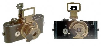

On to wireframes. The original Leica, the Ur-Leica, used a wire frame. I attacked the Gordodot with a black sharpie. Looks a little better. One of the things the Ikodot people claim is that after a while you will get a feel for the correct field of view without the wireframe. Using the empty accessory shoe works well for aiming and centering. Of course, if you are hip shooting, you aren't using the finder anyway and can just leave it off for miximum stealth.
